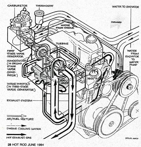

Reminds me of Smokey Yunick's(hope some of you guys know this man...sneaky bastard that he was)turbo'ed Super Hot Vapor car... a Dodge Omni that got a bizillion mpg and ran 13's....the concept is called an Adiabatic engine
in laymans terms...the incoming air and fuel would be mixed together in a first stage vaporizer..pass through a turbocharger..then proceed to a superheated vaporizer attached to the exhaust manifold that would completely atomize the mixture
what's curious here is that the turbo in reality actually acts like a check valve to keep the expanding superheated air/fuel mixture from backing back up the intake tract
presented it to the Big Three..nothing ever came of it..interesting concept though

Yes, I know (or knew) of Smokey. He was very clever, but he never got that particular engine to where he wanted it to be.
There was no "big oil" conspiracy. The right materials to make the engine work (and continue to work for a 100K miles) just don't exist (yet anyway).

Yeah Joe...I was joking about the oil conspiracy
the engine never did pan out for Smokey..it was a novel idea but as you stated.. the design was hobbled by inadequate material sustainability...especially for a product that would have to be warranteed
with the lean air/fuel mixtures required, the stoichiometry problems would eventually need to be addressed as the engine detonated under load...something Smokey swore it didn't
