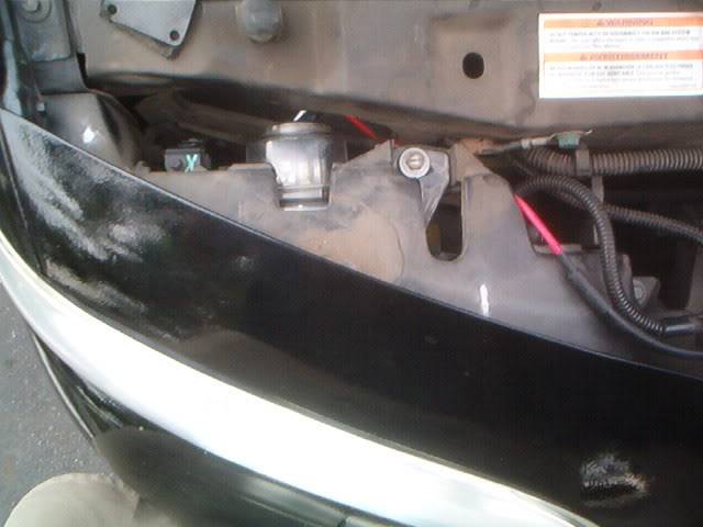

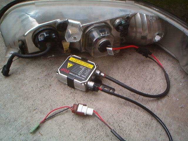

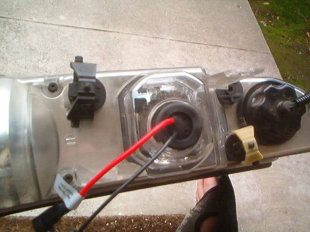

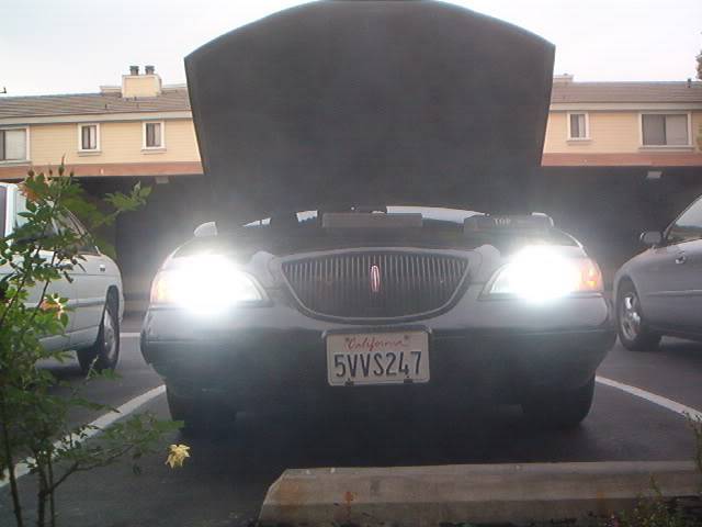

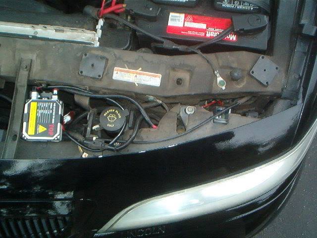

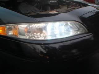

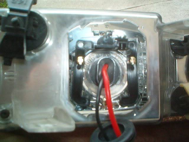

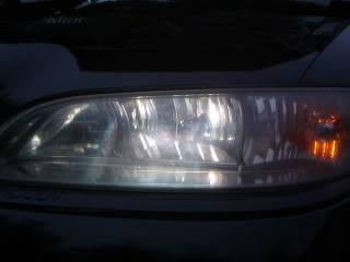

HID conversion is complete! Here are the pics-
ALOT brighter then stock!!!
New HID^
Old HID (stock)^
PioneerCrazed said:
That looks pretty interesting, have you had a chance to take it for a spin at night? Also, what temperature bulbs did you get? and where'd you get the hid kit?
Yes I have been driving since I finished on Wednesday night. Light output is great, same pattern as stock but brighter! I opted for the 6000k color temperature, I believe the stock one is around 4300k.

Conversion is pretty simple, remove the old HID bulb, disconnect the factory HID harness and ballast. Install the new HID bulb with the adapter plate I make, hook up the new ballast and tap the new harness into the factory wires that are before the factory HID ballast. Put it all back together and your done!
I can use any color temperature HID bulb, The place I order from stocks everything from 3000k to 12000k. The lower the color temperature, the brighter the light output. I have 6000k on my car right now but I would suggest 4300k if you want to keep it close to the factory color range.
I have had 8000k on my 04 Silverado and it was just too blue/purple for my taste.
