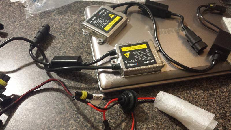

i have used 3 brands , DDM tuning , Xentec , and Klight , the best was Klight , worse was Xentec , DDM tuning is alright for the price
Klight - 170 dollars
DDM- 50-100
Xentec- 30-40

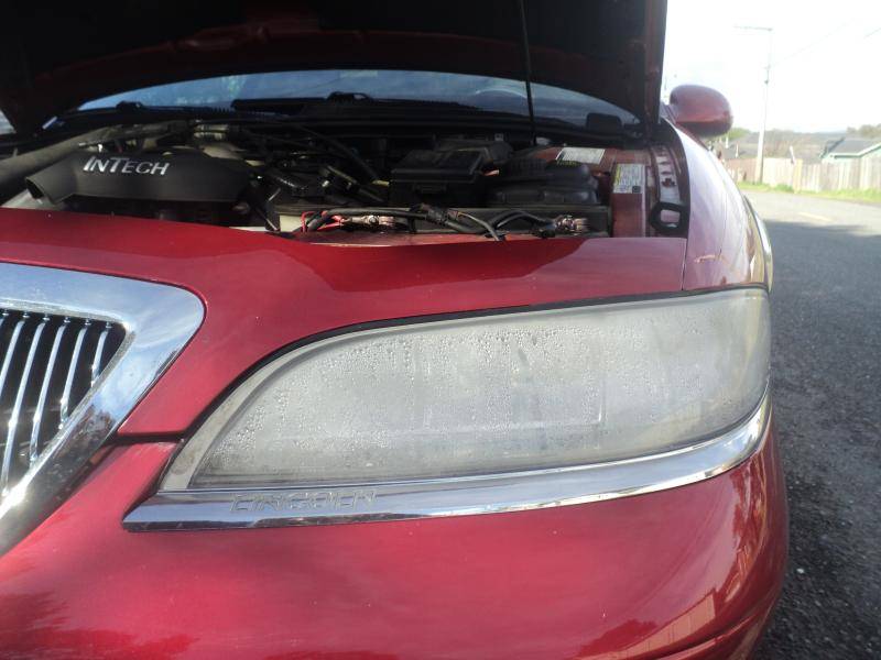

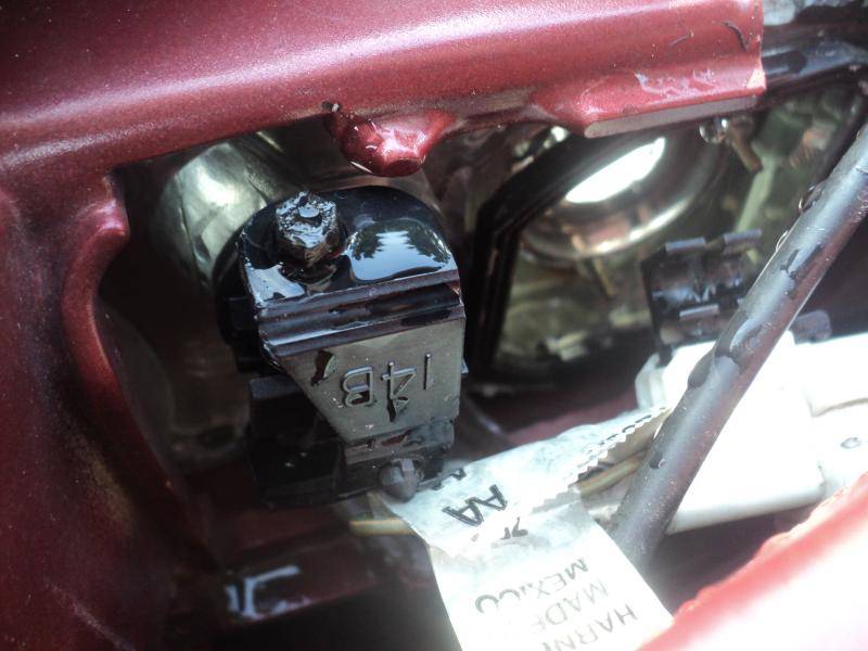

uhhh stock size? lol...... I think the houseing is messed up too. Which Is why I was hoping a kit came with that. being new sucks
How is the housing messed up? Is the chrome peeling from inside or is it just cloudy? Moisture?
Looks like the hid is gone allowing moisture to enter the housing.
If the wiring for the hids is still salvageable you'll still be able make a aftermarket kit work. Whatever you decide to do, allow the housing to completely dry out before installing the new lights.
Is there a hid on the passenger side and does it work? Does it too have moisture issues?

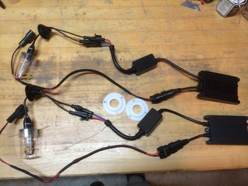

iirc, you'll need adapter rings that Jay makes, as mentioned above, @$50...pretty sure he'll also sell you a package with everything you need to convert. Otherwise get the lights of your choice (9005s?) and the adapters from Jay. Kensuns are good ballasts.
Daniel, I make/sell the adapters you need to be able to install aftermarket HID bulbs in your car. I sell them $50 shipped.
If you want to buy a plug and play solution for your car, I also sell a kit that includes both bulbs and both ballasts. It also includes the Mark VIII specific harness connections soldered onto it. It'll be the most complete kit out there, for the best price. Other places sell a similar kit for $299!! I sell them for $165 shipped. I currently have a 55w 5000k set, sitting here ready to be modified...
Yep, might be wise to purchase another headlight as well. If there's been water inside of it for very long, it's pretty well likely that the chrome on the bottom has disappeared...
