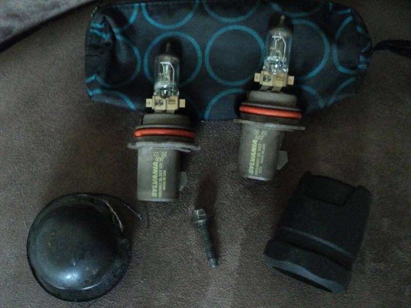

found these in the glove box........ 1 bulb has something rattling in it........the other looks to be in good shape.
these
these

Those bulbs are just regular halogens, the thing ratteling around is probably the filament making that bulb useless. Why they're in the glovebox idk, but they don't appear to be the right ones even for the high beams.

I recommend buying the whole kit together, since you won't be able to use the adapters without the proper bulbs anyway. I believe the ones you have shown are some jerry-rigged halogen bulbs. I urge you not to use them any longer...

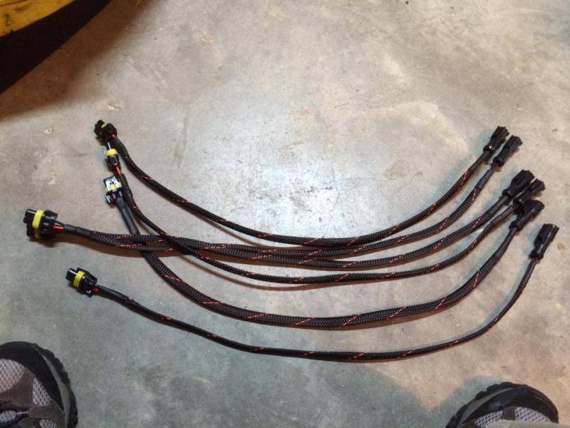

No wire-splicing. I've already done that for you. You unplug your factory ballasts, and you plug this kit in. You'll be responsible for mounting the bulbs into the headlight housings (using the included adapters), and finding a place to mount the new ballasts. Some people just zip-tie them to the radiator core support. Others make mounting brackets.
The benefits of plug-and-play: You don't have to do any splicing or soldering. I've already done it for you. I use butt connectors to splice the wires together, and then flow solder into the connectors to solidify the joint. Then I heat-shrink it and cover it with TechFlex expandable sleeving for further protection. You can see it in the picture below.
You won't need to remove the bumper, but you will need to remove the headlight housings from the car. They're held in by 3 bolts underneath the hood, and 1 phillips-head screw on the outside, close to the fender.

Here's a picture of the last batch of these that I made...
