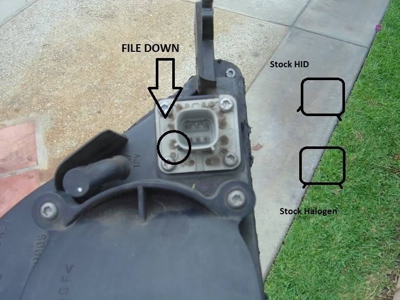

Hi everyone, I have a 2005 LS V8 with non HID head lights and I picked up some HID stock Assemblies. I tried to install the but the connecter looks the same but the tabs are a lil different. do I need different connectors?
No, you just need to file down the offending tab on the connectors.
Alax7 made a post not too long ago showing which one needs filing.
I knew it would come in handy. Here you go, this should help, and you have everything you need, just a very minor modification needed.
Great thanks. That what I did. Do I need to buy different bulbs or are the factory like the 6000k from DMM...
Stock hid bulbs are d2r 4300k, but you can use any temp d2r bulb. I wouldn't go past 5000k becuase then you'll start getting blue light which can't use it too see as well as white/yellow light
