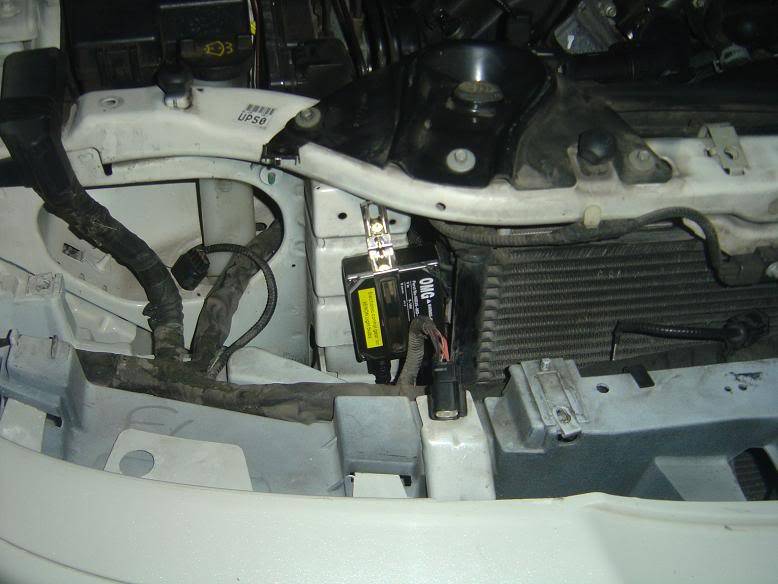

Unless you have the slim ballast, you prob cant fit them inside the headlights so you'll have to drill a hole for the wire to come through. If you have slim ballasts, you can stick them where I did.
Only with slims thoug, because with the fat ones, the headlight wont sit back enough for the screw to go in. The ballast in the picture was the fat one, but I bought slim digitals and placed them in that same location and with those, the headlights managed to sit back to its normal spot without interference from the ballast.
