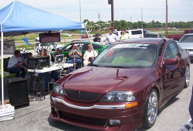

So i went to Team All techs show on Saturday. I decided to DB drag for the hell of it. Pulled 126 db (i know thats shyt for these subs and Amp. Sealed box tho =p ) And showed the car a bit.
