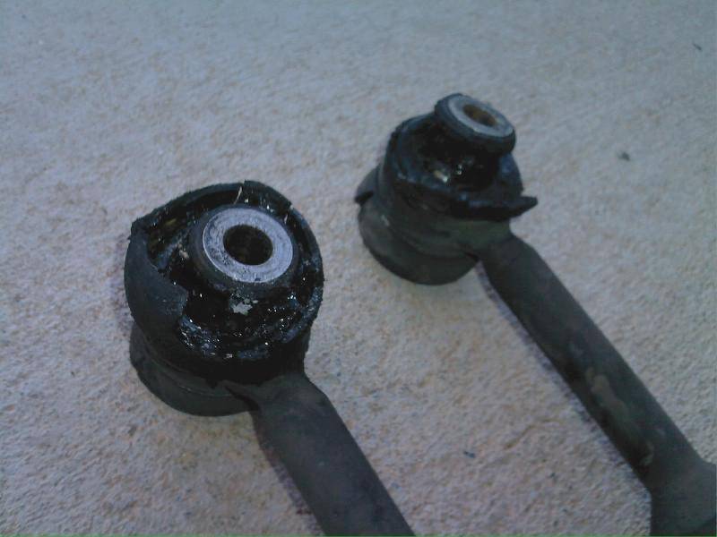

I crawled under the rear of my car without jacking the car up, and found these toe links had gone bad. I replaced them and the shaking/vibration is gone. Just slide behind each rear wheel and have a look.

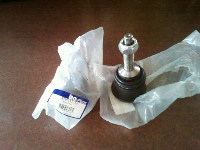

As some know this has plagued me for the last year. This is what I have done so far.
Wheels balanced a couple times with new tires: No Change
New front wheel hubs: No Change
Rear suspension toe bars: Slightly better
I'm up to replacing the front ball joints which can't hurt and based on everything else on this car that is original I'm quite certain they are originals as well.

I had the toe links, sway bar links and bushings and new tires installed etc and that fixed most of the vibration/shaking problem.
It wasn't completely fixed until we found that both rear brake calipers were stuck in the extended position, always having a brake "on" position and improperly warn rotors. I had the rotors, pads and rear calipers replaced... that finally made it roll nice and smooth, with no shakes or vibrations.
So my vibration/shaking issue was a combination of things.
