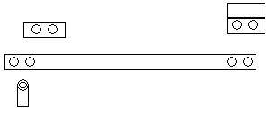

I drew out a plan for my connectors, but I made them so they can be unbolted so you can get the tank out.
Do you think making them this way would reduce the amount they will stiffen the car?
How about a setup using dual sleeves and grade 8 bolts and washers on both ends to allow you to pull the bracing but the contact points are still welded???
It's a crude drawing I know but it's the best I had at the moment.
