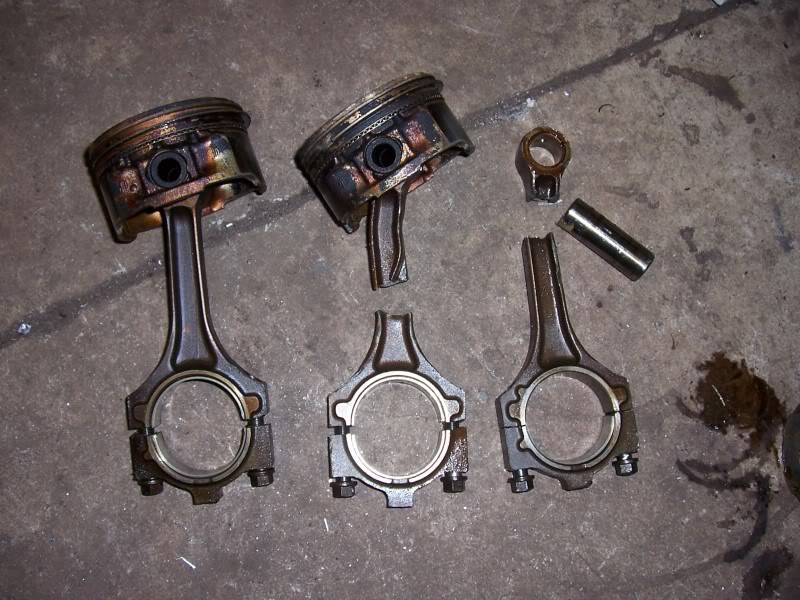

Yeah all done
Oh cool...those new 2 piece rods I've heard about...I hear they are a pain to put together but are dirt cheap!

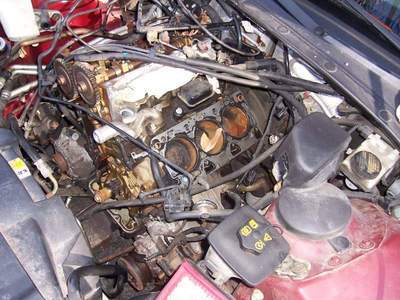

Ouch Right on the Mark - that hurts to even look at. Did you run into any particular problems pulling out of the top ? Any gotcha's to watch out for? With the radiator out and the front of the motor torn down it looks like there is a ton of room to come out the top. Did you pull motor/tranny or did you separate ? The top bolts on the tranny look a little tough.

I have a complete garage with lift and hoist. I stripped dead engine down to block and me and my friend pulled it out by hand. This made getting to all bolts bit easier. I left trans in car. I got to all bolts so not to bad. The funkiest parts are all the pumps on engine. The fan and PS pumps need fluid lines taken off because they cover a mount bolt if I remember correct. Get new teflon "O" rings for any and all that need them. Also teflon "O" ring install tools. I machined my own if I can find pics for ya.
For "O" ring tools look on my thread page 3 post 64 for pics.
