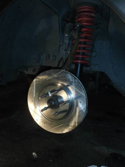

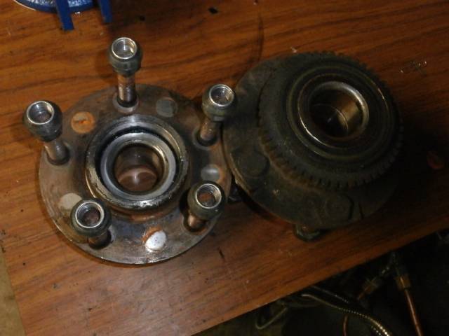

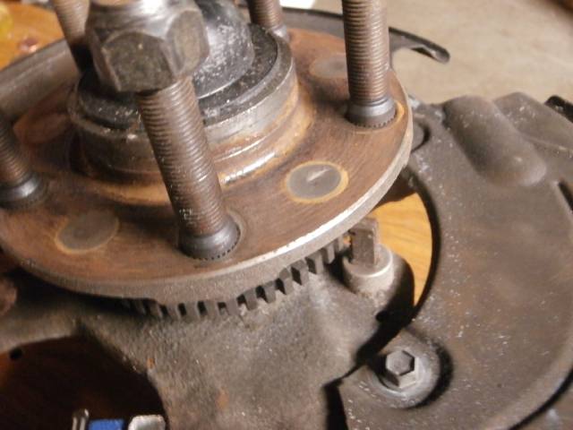

Is there 10 holes in your front hubs? Take a picture of the back side of your 4.5" mustang pattern hubs.

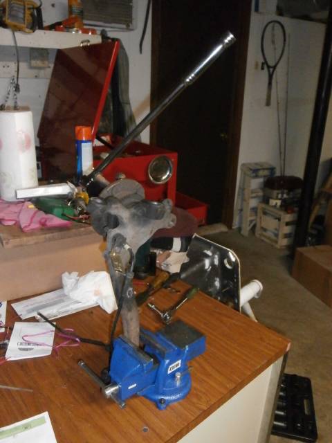

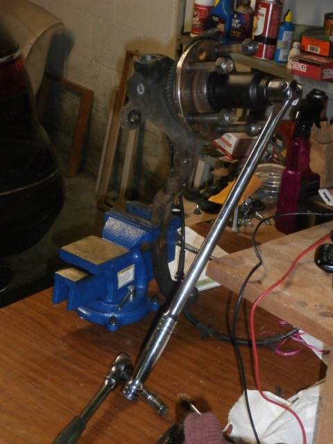

I WIN! LOL The front hubs slide off like butter. If you can't get those off hang, it up. Rockauto will take hubs back no problem. You will have to pay to ship back thou.4 mark viii rotors, 2 mustang hubs
if I don't get the old ones off those spindles I'll just use the new ones...bad on me for ordering the hubs before verifying I need em, it's only money :shifty:

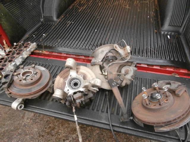

....reality is I have 2 marks, and already have a set of corvette PBR calipers I could use on the white car later on...
They go off the rim so I would not think it should be a problem. But large dia tires are not my thing.using the 35 is easier than using the 36mm socket;
putting the 4.5'' hubs onto my car i stood on the breaker bar- i weigh 200lbs so they are torqued to spec? :shifty:

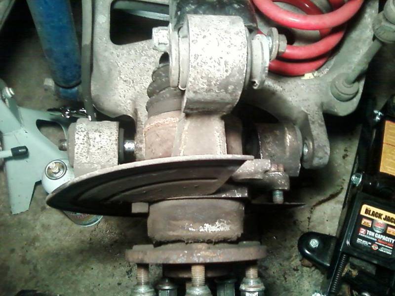

...now to rassle those rear knuckles for r/r....

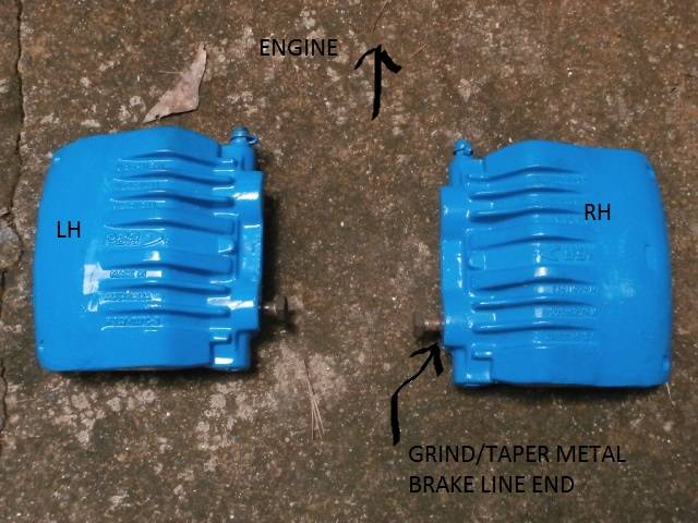

my calipers aren't marked RT/LT, pretty sure this is right....si?
yes. bleeders up!
indeed they are stamped- adjacent the banjo bolts, so big I couldn't see it!I'm betting they are as it's part of the casting.

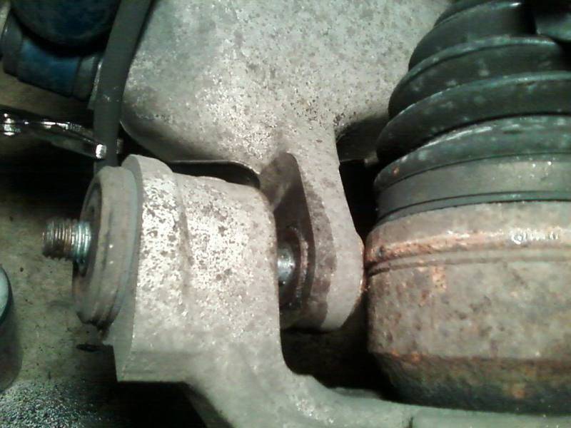

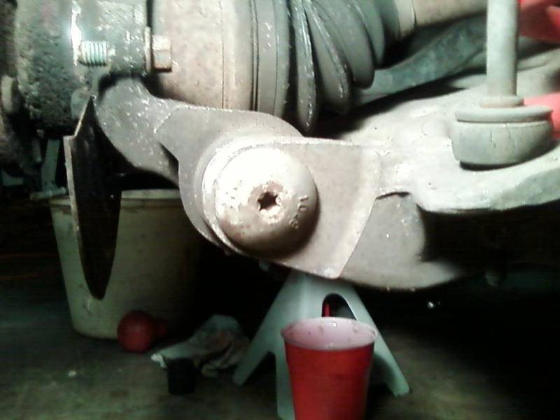

You have to loosen the nut. The T50 doesn't have the strength to loosen the bolt.
