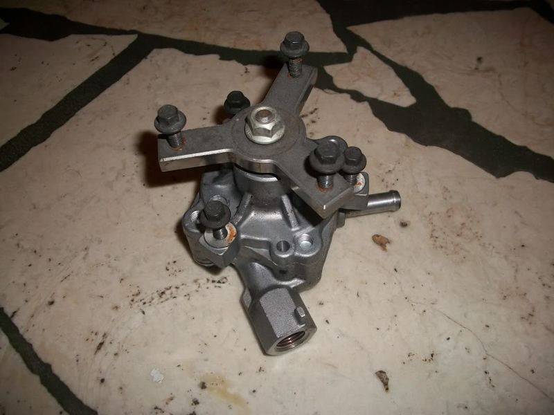

I have my original that I'm not using anymore and can sell it.
I have one out of my 02 LSE that works fine. If you are interested I'll post it on ebay and send you the link. $125 shipped to you. PM me or email me at hite337@live.com

thanks! that is the motor right? lol
My husband checked it out today and couldn't find leaks anywhere from the reservoir the hoses or the pump so he is assuming it is leaking from the motor. He couldn't pull the whole assembly but he is 90% sure that's where it's coming from. I will get back to you in a day or so to purchase it.
