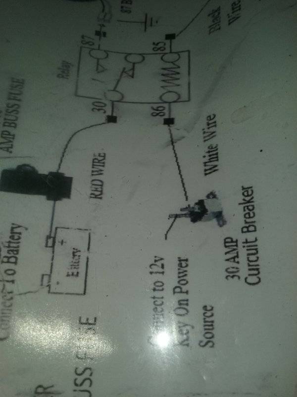

hello Joe and again ty for your help as i go. I have 3 questions now and maybe 2 more im sure you can help with. As i dont want to take too much of your time man , ty.
1- on my instructions chart (map)to make a safe key on power source i thought would be best to cigarette light key on source. thereforer to 32 i go , power side of fuse. however its in side cab -pside and im struggling to see clear pathway... Should i just drill hole or is there a secret pathway you may know?
2 would be a coinside que. because i hvnt taken a reading from power source in p-side well yet( and say its not a viable powering source), because prior owner. illmap ht ling from battery...It jkust seems to me that messing with fuses at this big move is kiunda crazzeee
in the fuse box that is.. i understand inline fuse importance
my next step after power source will be to tap into key on source. im aiming for cig lighter. but inside thew cab
i just ordered new belt, gonna go extract pump from hydraulic hell and look foward to learning the besty way to do rite, 1st time ty kind sir--- I promise to pass forward my good fortune,
The power ports and lighter are always powered. They are not "key on" sources. There are key-on sources in the under hood fuse box.
