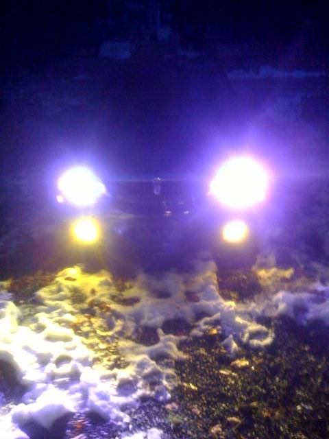

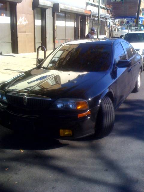

shes all stock beside the new tints all-around and 30000k xenons shes stock. just changed the plugs and all the gaskets, right control arm just came in so this weekend going to swap it in and start looking at the bushing and shocks to see how they look
