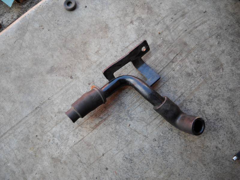

Do I need to replace this whole part or just the rubber on it??

the PCV is that thing sticking out of the back of the box, just turn it counter clockwise and it will come out, it is just a short tube, the box is fixed! go get a new pcv and you will see what it is. Next! the elbow comes as an elbow, nothing more. take old elbow off, put new elbow on, done. twist new pcv into hole in back of box, done! put elbow on pcv, done! start putting it back together.
Thanks guys, I am on it today!! As soon as I get the PCV valve replaced I can start putting it back together, I'm finally looking forward to that!!! I will update if I need anymore help but I think that I finally have it under control. I know how it goes back together, and have the parts replaced that I can replace, and today I have assistance in putting it back together....so booya for me!!!!

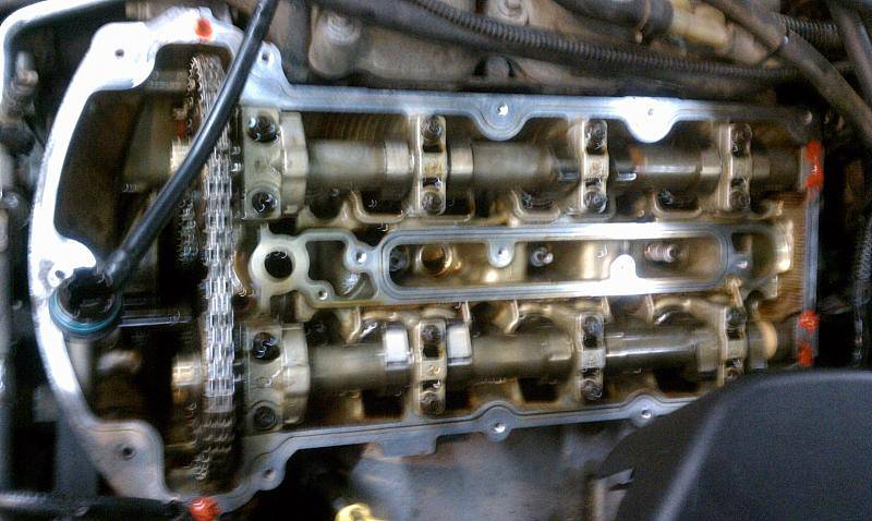

Set the wrench to 8 foot lbs, 7.4 if it resolves to that amount, torque it in proper sequence, 3 times, as the first bolts you torque will be loose after you torque the surrounding ones. Same with the valve covers. Also, be sure you have cleaned off all grime from your valve covers, inside and out, as well as your camshafts. I cringed when I did these 2 months ago, at how easy it would be to spill dirt into the cams and ruin them in short order. Keep your intake ports to your heads well plugged and carefully wipe the grime off the head's mating surfaces before plunking your new gaskets down, as well as the surface of the lower intake where it meets the gaskets.
The sealant is used where the head's components are joined together (different pieces of metal). Carefully remove the old sealant from the 4 locations and clean it well with non-residual solvent, dry it, then add the new high temp RTV sealant in those locations.

8 foot pounds is correct. I did not use sealant on mine, but it would not hurt to apply it to the spec. locations. you're almost finished.

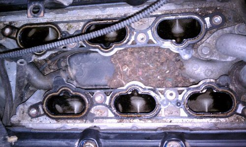

Finally finished!!!
Well guys I'm finally done with this!! As I got assistance in putting it back together it went pretty fast...then I found out that a spring fell out of a coil under the intake so again today off the intake comes and sure enough missing a spring :mad: BUT, now it is all back together, very nice and purrs like a kitten. Better than when I bought it!!!!:cool: I very much appreciate all the assistance that you guys gave me, without your help I think I would have been lost as my friends who know a thing or two bailed on me!!!
My hands are still filthy BUT my car is running and I don't think I messed it up too bad! Maybe a few "studs" out of place but over all I had a mechanic friend torque them down so as not to get too tight and I will be driving it to work tomorrow without the missing spring....let's hope that this solves the infamous check engine light, which is why I started all this in the first place!!!! :eek:
I'm glad I'm not the only one who had mice problems....ugh that is one thing that I don't like at all.... finding that in there and knowing there had been a living thing crawling inside my engine...ick! Anywho, thank you all for your help I will be getting the dccv (anyone got a part number on that??) soon then as it has been determined that I will need it going into the summer months. BUT, that is a job for another day....Today I will just be satisfied that I have one problem solved and see where tomorrow takes me!!
