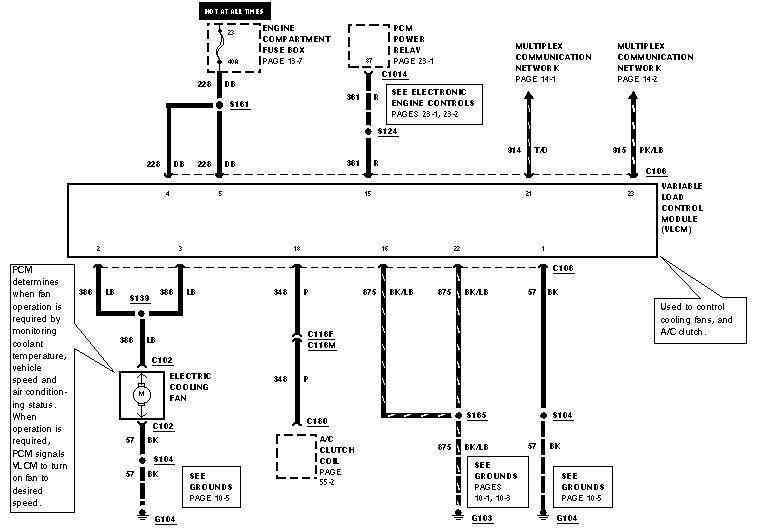

On a Gen 2, the VLCM only controls the cooling fans and the A/C clutch (first diagram).

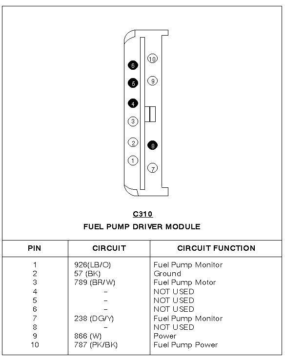

Check for power at pin 9 of the FPDM (the "C" triangle in the last diagram), or the output of the IFS (the "C" triangle in the third diagram), and then work backwards thru the IFS, relays and fuses until you get 12 volts to find the problem.
If you have 12 volts at the IFS/FPDM, the check the output of the FPDM betwenn pins 3 and 10.
If you have power, then the pump is probably bad.

the pump was the 255 LPH high performance fuel pump from ebay, and i know you get what you pay for, it was only like 50 or 60 bucks, and i just opened the pump housing and replaced the pump and the inner and outer sock filters and reused the plastic pump housing. and no it wasn't a walbro. i thought it was at first, and i was wondering where are the locations of the units i need t test, and good info gathering there thank you DLF, and every one else, i will post the results as soon as i figure out these units locations, i am sure at least one is in the trunk
i am reading 12v at the wire right next to the pink and brown or black stripped one, i think it is a beige or tan color one that i am reading power comming from and it is the only one showing any power in that FPDM plug
Did you test for power at pin 10 with the FPDM plugged in and the key on?
no i tested it with it unplugged but i will go and test it right now with the harness plugged in,
Without the FPDM plugged in, there isn't much chance of testing whether or not it works. :rolleyes:
no power at #10 with it plugged in and the key on, so what do you think the diagnosis is DLF, and thanks again for the added support on this one
Well, I'd double-check pin 10, and also check pin 3 (in case I'm wrong about which is power and which is ground to the pump), but it sure sounds like the FPDM died.
It also possible that the cheap pump may have killed the FPDM, so even replacing the FPDM might not be a permanent solution. :(

pin 3 shows no power either, and i double checked #10 still nothing, so i guess next question is how much do you think that FPDM will cost me?
