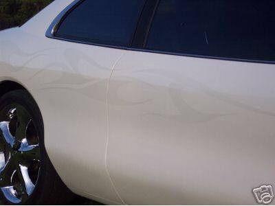

Beautiful.!
That deck lid is just not right. A nice new lincoln emblem from a navigator/MKZ would finish it off, in my opinion.
I agree......but at that point it was too late due to the fact that it was already done....LOL
I was going to put some graphix in there or maybe the plate holder....but no longer own it and workin on another one.
