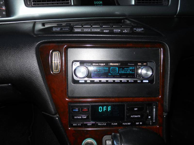

Mill stereo surround plate clearance

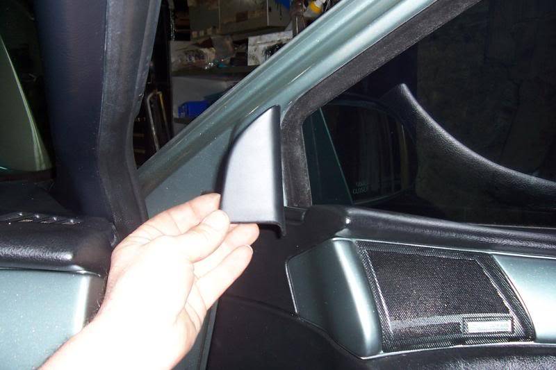

Pass door mirror trim piece

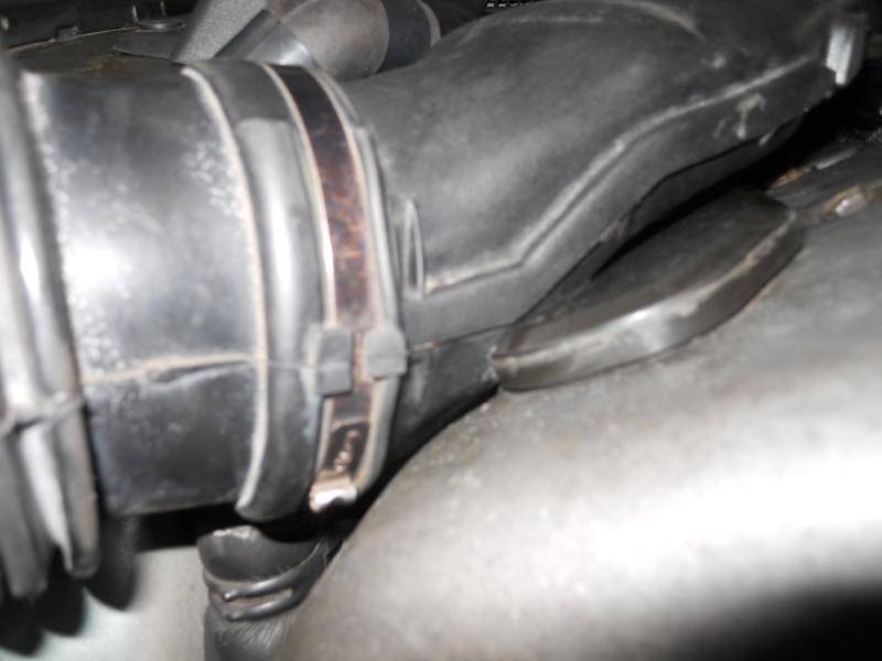

Smooth air intake tube

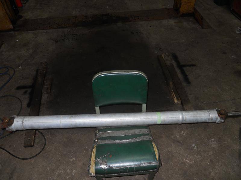

93 one piece Driveshaft

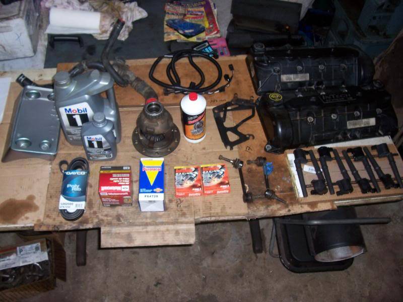

Here is most stuff I had to pay for.

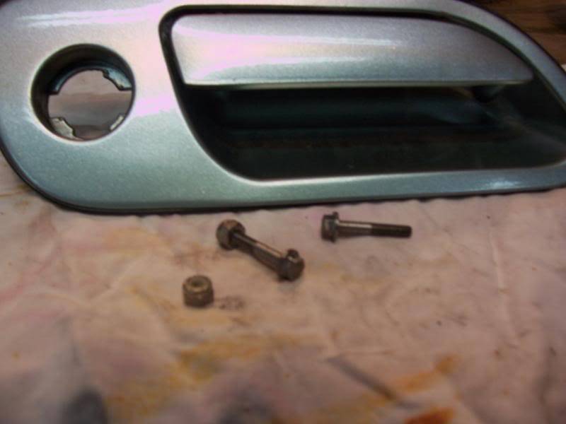

Even made billet door handle pins 8-32 thread FYI

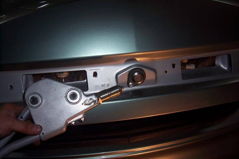

Big butt rivet gun for trunk lock

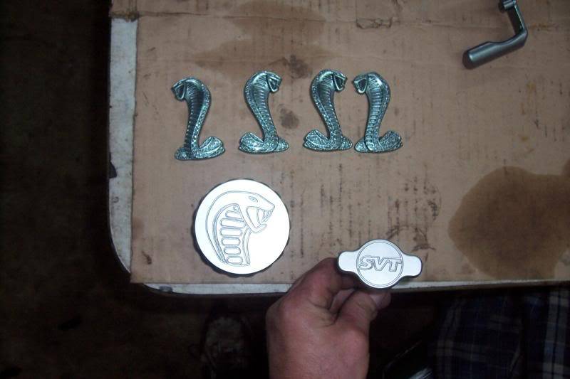

Bye bye snakes and alum. Alum might come back when I switch to cobra intake

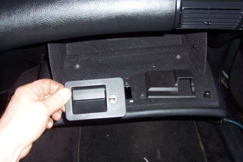

Glove box lock change

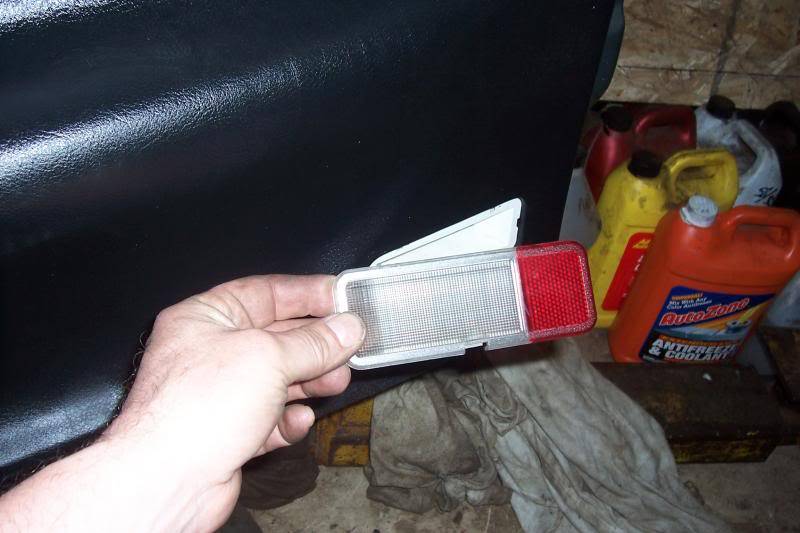

Nice lens that does not fall out

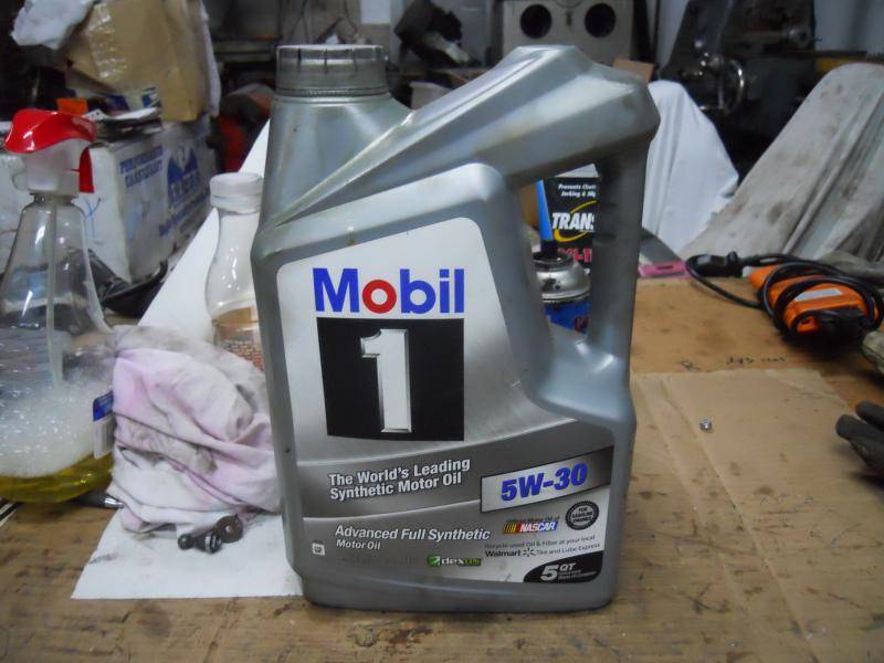

Yummy oil

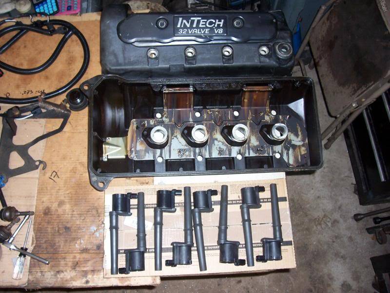

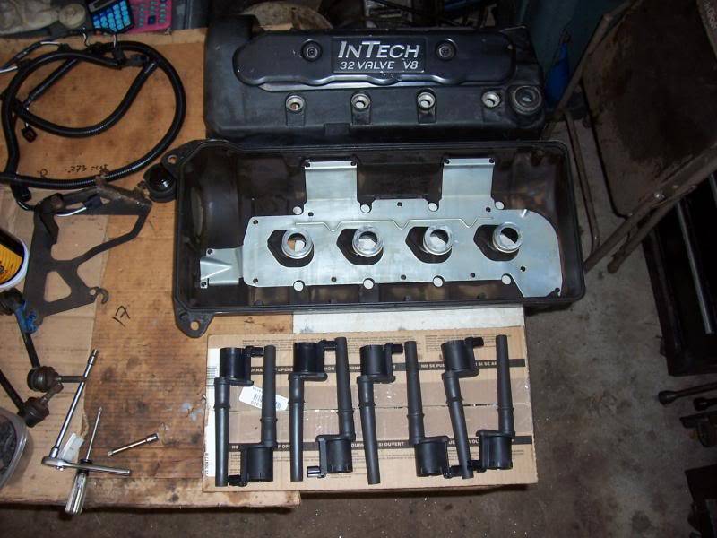

Dirty Cop Valve cover
Clean Cop valve cover LOL

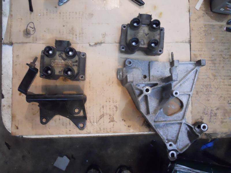

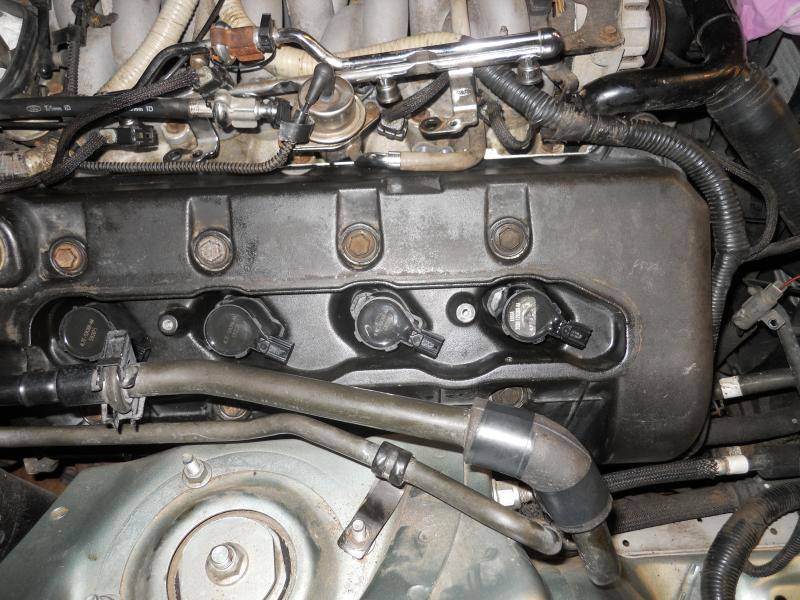

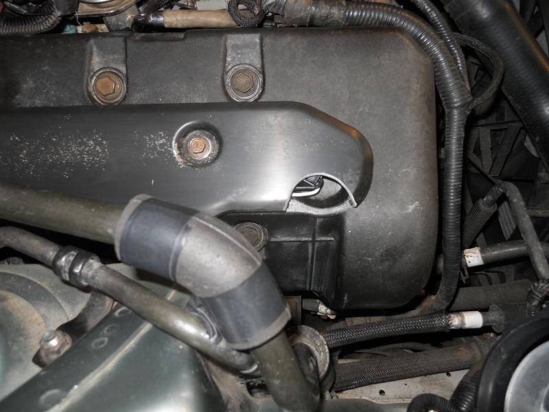

Now to get intake to drop enough I had to relieve the COP cover
Here is shot showing the fit

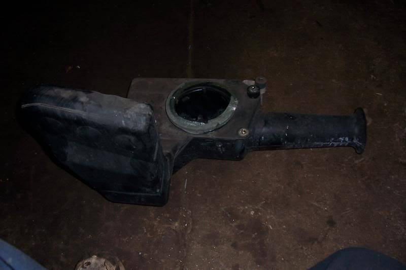

Air tube smoothed and plugs ready to go
Snorkle tossed

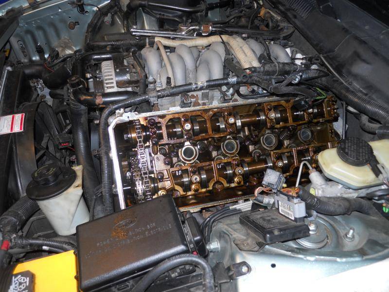

COP valve cover in Pass side. No need to pull engine mount bolt just jack up engine as high as it will go and remove FP reg to pull VC.
Drivers VC little harder. Engine mount bolt has to come out jack engine up. The stock VC will come out but to install COP VC had to unbolt master cyl and push to fender to squeeze in.
These get removed from front of engine when switching to COPS

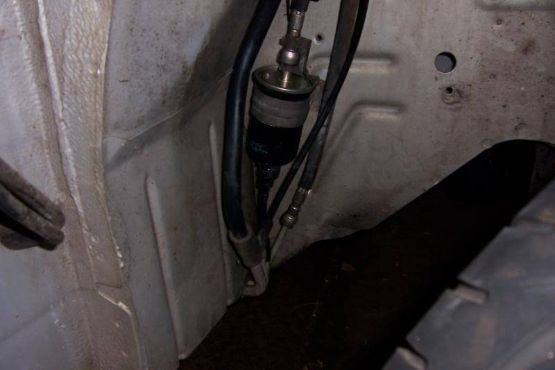

Nice new Fuel filter. Man the old one stank.

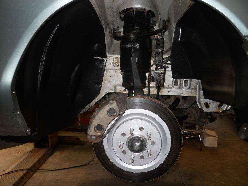

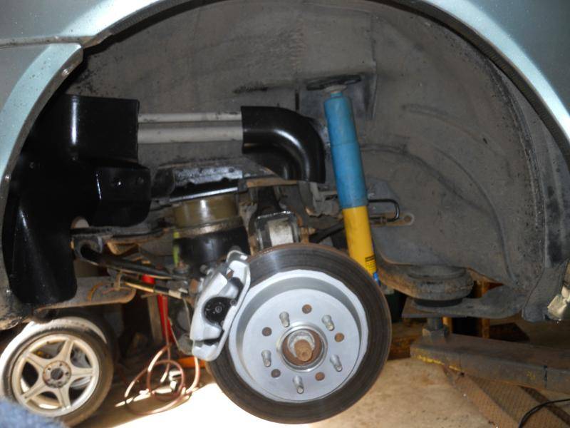

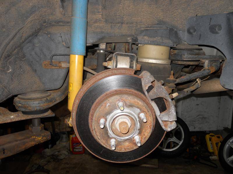

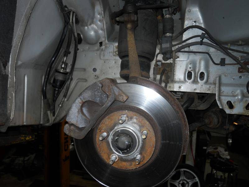

On to Brakes
Front Stock and ugly
To this
Rear stock and ugly
All pretty

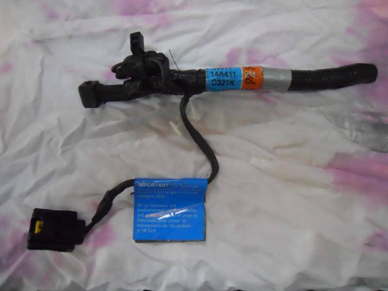

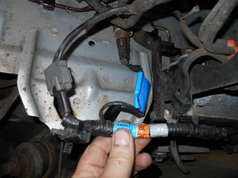

Recall harness
Mounted, lets try not to catch on fire

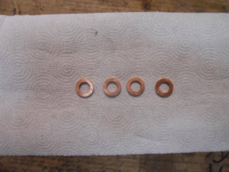

Here are the front caliper copper washers I like to make up

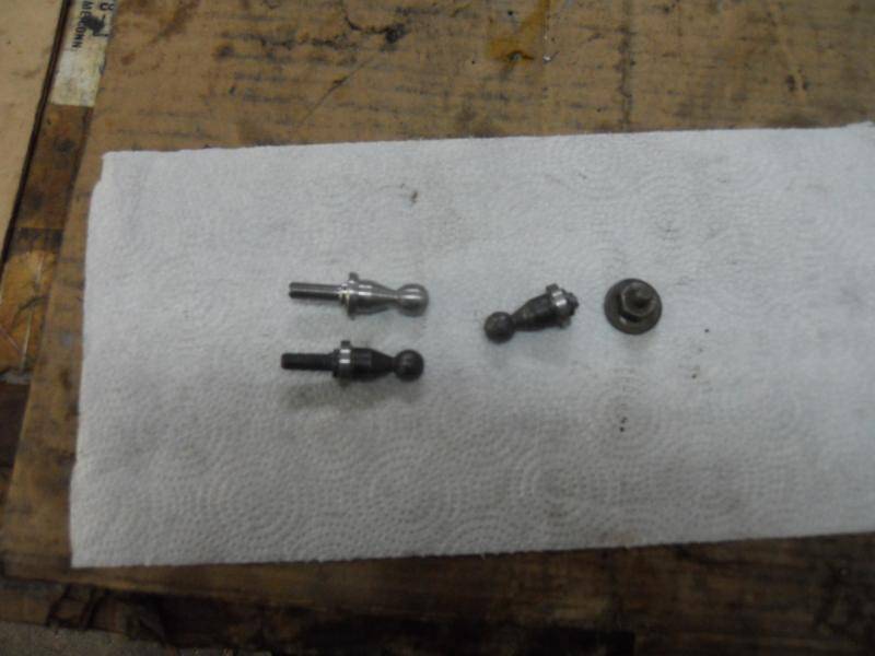

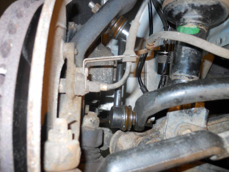

To sensor lower I turn down the OD of front ballstuds and grind out the mount all the way up. This makes the ballstud mount as high as it can in stock mount bracket. I like this lowered height. Here you can see turn dia and the ballstud I had to make.
Added a pair of tight non ripped boots swaybar end links.

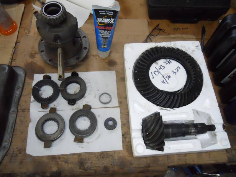

I will be building Ice's rear end. I will have just the price of syn gear lube for bill. Only thing new will be crush collar and pinion nut which I got for free doing gear jobs. Posi was free found it upstairs. Oh cool a posi. Gears free from a 4.10 swap. I will super clutch it since I save all the clutches from my reclutch jobs. Don't think I will do the F-150 "S" spring though.

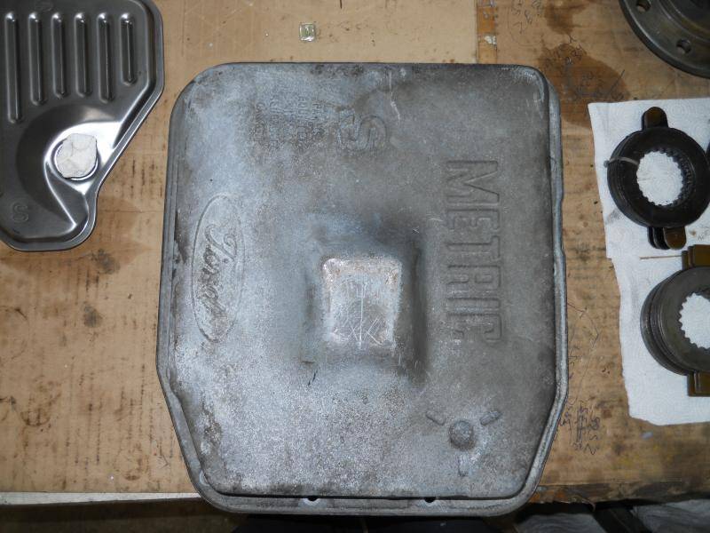

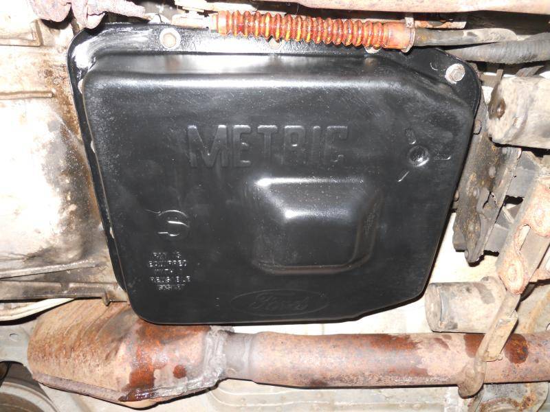

Just got done doing trans. The valve body "Buzz" in P and N is now gone. Thank you! The buzz is from dirt or something in one of the piston valve bores making is not seat and bounce back and forth and flutter and buzz.

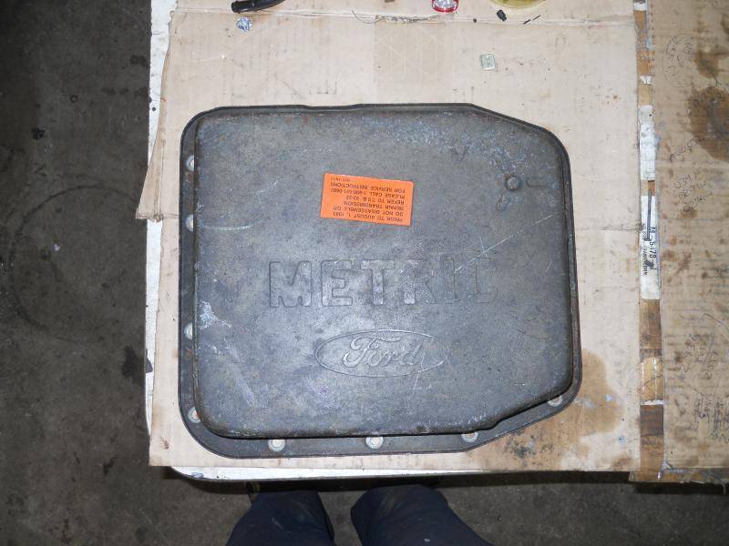

Old non "Dimple" trans pan
New "dimple" pan this helps trans NOT neutral out taking a hard right turn. You need matching Gen2 trans filter to match pan.
Stealing pan off 97 trans, stole the reusable pan gasket too because someone put a cork one on Ice. BAD

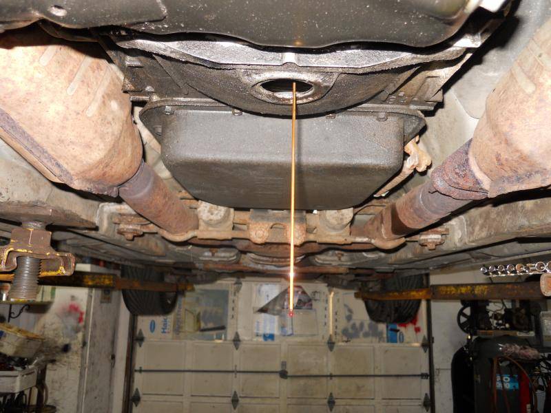

Tip for draining torque converter take 6 inch piece of coat hanger and make 90 degree 1/4 long bend on one end. Remove TC drain plug and insert tiny hook end into plug hole. This will act as a vent and let trans fluid flow like mad.
Flowing, FYI 6 qrts come out of the converter!

Thanks for all of the pics, most especially of the recall harness which I came across for the first time in the 98 yesterday because that sucker was swinging wildly in the wind. I thought there was a rattle in the wheel well and discovered two zip ties on that pigtail that the Lincoln guys managed to secure to nothing. Very nice. At least it was a free repair! Lol.
Recall harness
that's the "bad" recall harness, the fuse is on the wrong side. they reissued the recall to replace the faulty harness with one that was fused on both sides but most people didn't go back. ford also has a replacement switch and pigtail to a newer style, in case the switch was leaking when they came in for the recall, but you can buy it and do away with that stupid jumper.
Good to know. I stole this one from my F150 that just went in today for jumper and 5!! other recalls. I can bring Ice down and have new jumper put on. I just went out and disconnected the jumper and switch. Car is in garage up on lift and I could not sleep tonight wondering.

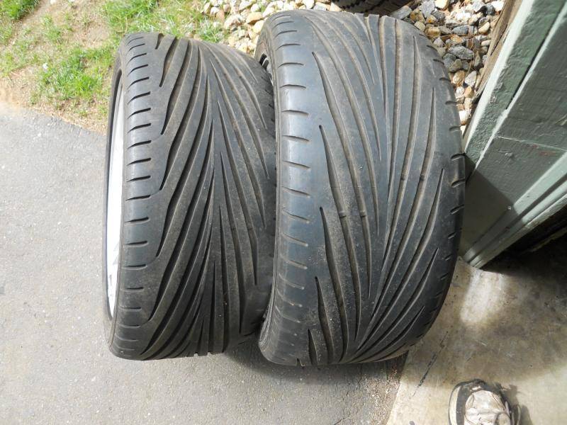

Ok ok I sprung 60 dollars and got a set of 3.73's LOL And I picked up this for 60 dollars too.
