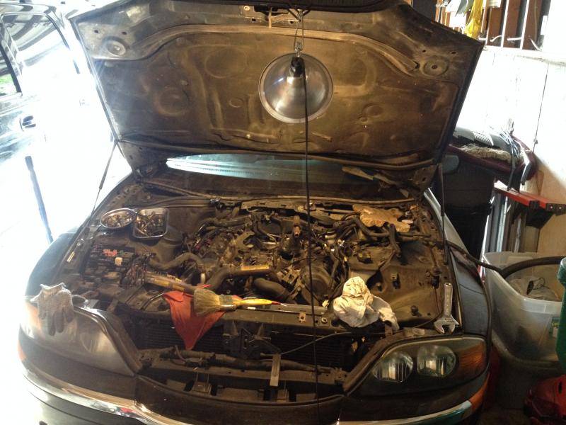

Well I finally have had time to get this LS up and running to get rid of her and it appears she just doesn't want to go bye bye.
Lizzy 4 or 5 as I like to call her is a 2000 LS 3.9 with 148,000 miles of fun amazing nights and some long horrible days working on her. I think I've replaced coils way too many times on this creature but here is my current issue. First some background.
P/S Secondary chain and tensioner, electric fan upgrade, 2 new intake valves (I cheated and replaced the tensioner only at first, well dumb dumb me). After sitting for a few months due to her reliability being often questioned during hot steamy summer months here in St. Louis and I've replaced way more than I should list, anyways after sitting it wouldn't start due to a bad fuel pump, replaced it along with the CHT sensor (probably my 3rd or 4th time removing the manifold), new coils, new spark plugs (motorcraft) and a new battery and this naughty girl now idles like a cammed mustang for some reason., once revved up she has all the power she demands yet disappoints once shes idling again.:shifty:
I've checked spark plug gap, vacuum leaks, MAF unplugged (its only a yr old) now I'm starting to second guess myself and thinking of replacing the intake manifold gaskets and start from there on up, again. I need to replace the D/S secondary chain and tensioner anyways. Coil and Injector connectors aren't in best shape (don't click) so I've pushed them in to hear if idle regulates but nothing?!?
I get (P0171) Bank1 too lean and (P0175)Bank2 too rich codes which I'm just lost unless of course Lizzy doesn't want to part ways with me and is trying to hold on in anyway possible.
Any ideas? I'm replacing the fuel filter, again. Personally I think shes jealous of the Town Car and Passat (needs new oil pump, next project :mad:)

I would think a gasket like mentioned. A burnt valve can give a car a rough idle like that. Maybe do a compression test before pulling the intake if you can't find a vacuum leak.
If the idle is rough enough, you could pull the power to the coils one plug at a time. Whichever cylinder you pull that affects the idle the least, is going to be where your problem is. That is where you need to run the compression test.
The 2 valves were replaced in 2011. No issues back then but I will test compression to see what it reads. The only hose that I "can make leak" is one of the two on top of the throttle body, if you're standing at the front driver side wheel looking towards the motor its the right hose on top that feeds the booster, evap equipment and also goes to the intake tubing. I sprayed throttle body cleaner on various vacuum hoses yet heard no idle acceleration.
Any idea what the compression should be on this?
I'm awaiting to receive the tensioner and chain I ordered to dig into the driver side valve cover. Also I will dig everything back out and reinstall new gaskets in the slim chance that perhaps I've snagged a gasket either on the manifold or throttle body.
