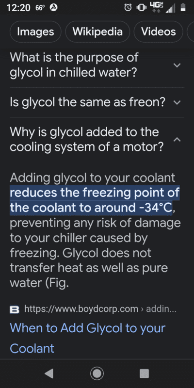

Its highly unlikely to happen if you use good coolant. The boiling point of the water at 0.7 bar pressure is 112C. Using good coolant it raise up to 125C . Except in some kind of racing application i doubt you can achieve temperatures of over 125C of the coolant anywhere except maybe the oil spraying on the pistons themselves. But as i said this is , if anyone is interested . OEM the system works great, but for me its overpressurized in order to safely assume you can use plain water for cooling. If you don't do that you have a margin that you can safely use.
And those antiques were designed to use a "drip system"... which meant constantly monitoring the coolant level... and refilling when necessary.
And you think they will shoot themselves in the leg by providing a car that cannot cool on water in order for someone to quickly destroy it after the warranty expires? Then the whole world to understand their cars are trash and overheat like crazy 3 years after production ,around that time the warranty were around 3 years for most cars. I dont think anyone will will ever do this mistake, even if you put water in the LS now you can probably drive it for years until a problem occurs except in cold climates ofc.
