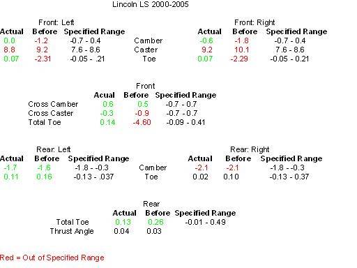

Ok everyone below are the results of my alignment after lowering 1.75. Can someone please tell me if this is ok or do I need to take it back.
That looks fine, it is nearly impossible to get perfect alignment on a used car. I watched an Auto Mechanic teacher do my alignment and a couple places couldn't be perfect without replacing large parts.

I wonder why the Caster is out? Won't hurt anything, but I don't see why lowering the car would bump the Caster up. Just do not know enough about the geometry of our suspension I guess.

When I had my car lowered the dealer couldn't get the caster adjusted enough so mine is out. I have slight oversteer sometimes on hard bumps but since I've had my car lowered for well over 2 years now I'm use to it. I guess there isn't that much adjustment for caster on LS.
A little off on caster shouldn't create any problems. Maybe just a little oversteer at times when going over bumps.
