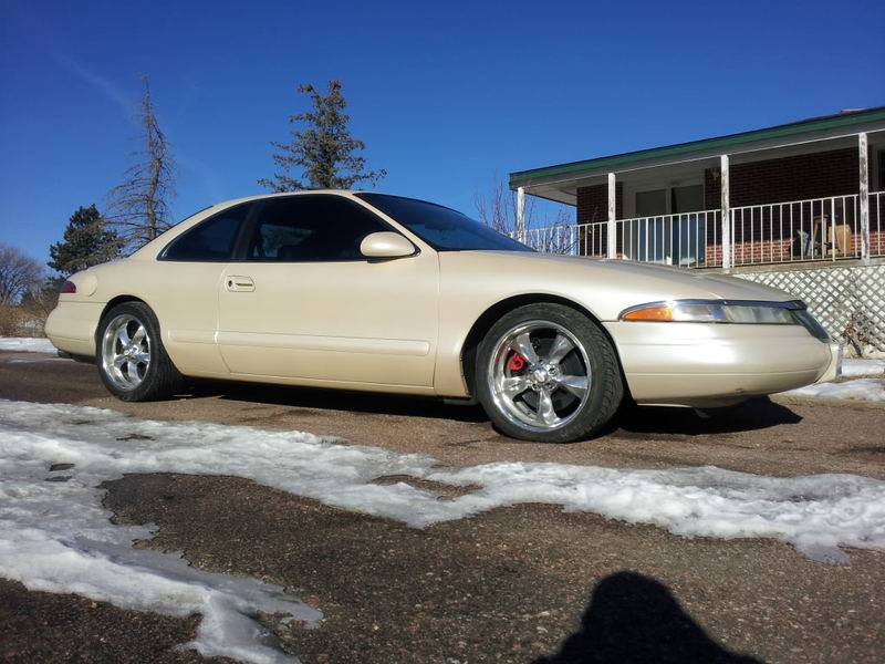

You will be fine. I have bullits on mine, 18x9 fronts with 265/35/18 and rear 18x10 with 285/35/18 and don't have any rubbing issues.
