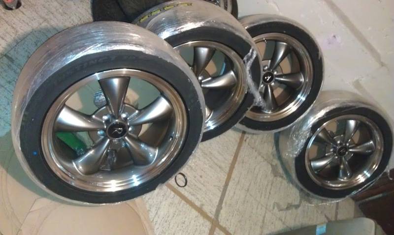

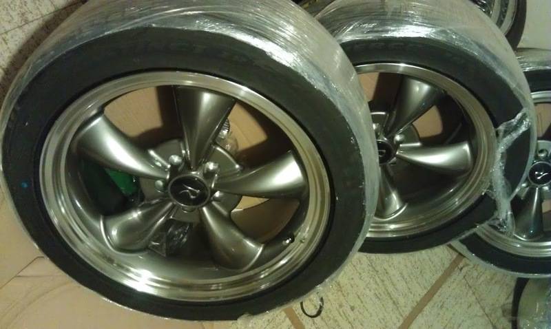

Thanks for the info guys. Not sure if I would have different wheels but it would have been nice to know the 05's worked.
Finally bought. Will try to fit them in a couple of weeks.
Oooh, those looks absolutley great! I want to see them on your car! :D
And welcome! Fun seeing more of us europeans here!
And welcome!
I sold an oil pan to a chap from Moscow a while back. Nice to see so many VIII's in one place over there.
Hi 94m5,
You sold the oil pan to me. It was installed on MARK and car run greate again!
Miha, you don't tell the others I bought the wheels! :D
They are now moving to me be sea freight.
Going to be a kind of surprise.
