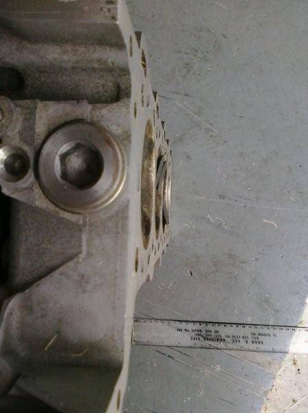

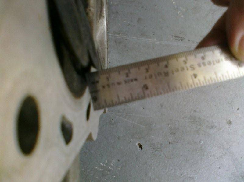

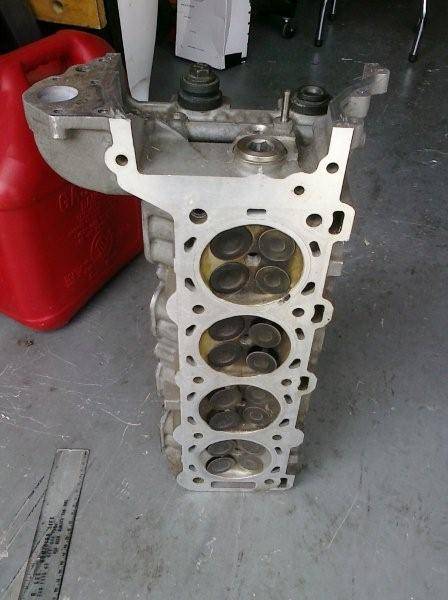

here are a couple of pics of some LS heads I have....
Sorry took them with my phone..
looks like the valves extend past the edge of the heads by about 7mm.
I do not have pics of the piston in the cylinder at TDC - so I do not know how high it come to the top edge - but 7mm seems like a lot.

If the valves do extend into the combustion chamber 7mm, (as Cam's 3rd pic in post #30 shows)...
...and the piston at TDC is 7mm from the top of the block deck... then, (allowing for the head gasket thickness), the valve is almost hitting the piston on a cold engine.
Start the engine up... and as everything "grows" due to thermal expansion... then the valve and piston would come in contact with each other.
