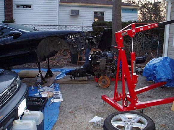

so How much is the nose off the ground lets say from where the bottom of your license plate holder (sould be) whould be to the ground. how long do you think it took you from jacking the car up till you step back, exhaled and said "well its out!"?

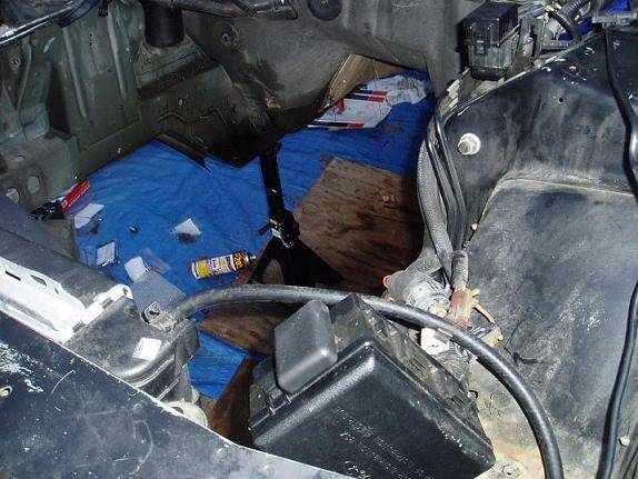

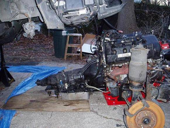

umm I jacked up the car yesterday but didn't unbolt anything.. and today it took like 2 hours to drop it down,ball joints took a lil bit to get off. I figure after that and jacking it up more.. took about 3-3-1/2 hours total.. not too bad for the first time.
PioneerCrazed said:
What are the plans while its out? Not bad at all for your first time...
I blew my 96 motor, no idea how but it eventaully seized, probally a rod or something deep in the engine I was told. at least a quart of oil blew back into the intake.. when I took it off oil went everywhere. so thats the story behind this.
I plan on putting a 97 mark engine in place of it and while the engine is out throwing kooks headers on and getting a custom exhaust. My original plan was to build up a motor and get the best of everything, but for what I wanted to do, the price was way to high.. over 6-7 grand plus headers and a full exhaust. so I found a great deal on a 97 engine with 44k miles for $500 bucks. and thats what I've been working on for like 2-3 weeks now.
For the most part I've been working by myself, a few friends helped me drop the engine, and my one friend helped me with the exhaust. I put in a few hours per day(when its nice) and don't kill myself. it also gives me time to buy the parts I need cause I don't have lots of money. I say all together I've put about a soild weeks work so far on the car. probally another week or 2 to get the engine back in, then another week to get her running. but we're having house construction so idk how much I will be able to work on the car. I wanna get it running by the beginning of may, middle at the latest.
