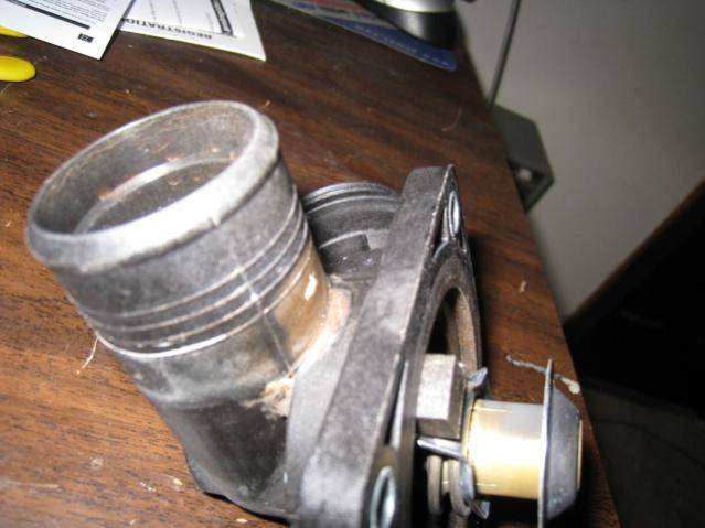

If you're going to replace the thermostat, go ahead and replace the housing as well, it's possible that it's broken off from its weak plastic mounts and is not allowing maximum flow of coolant, this thread gives you an example of how the plastic cooling parts will degrade and break over time http://www.lincolnvscadillac.com/showthread.php?t=84514. When I replaced my plastic cooling parts last month, it wasn't as bad as what's in that thread, but the plastic pieces that hold the thermostat in place were both broken off.

Mystery solved. My thermostat housing is cracked. When going through the bleeding process I saw the antifreeze leaking out through the neck of the filler tube.

While cracking of this part is common, don't fool yourself. The engine fill tube neck has a passage in it from the wider part of the neck where the cap screws on to the outside. If you fill coolant nearly to the top of the neck, it will pour out from lower on the neck. It looks like a leak, but it isn't. The o-ring in the cap is below the passage, so it won't leak with the cap on.

Arghhh. Yep, I fooled myself. I've already ordered the part too. It was a bit low on water so i filled it back up. I even tested to see if that quart or so made a difference but it didn't. It still went straight to 225* within 10 minutes of idling. As soon as I started to drive the car it shot up to 230*.
I'm just going to replace the thermostat, the housing and bleed the system. I suspect that the thermostat spring isn't compressing quickly enough or far enough anymore at is warms up.
