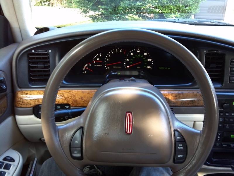

ive done that swap in my conti( and added the black newer lincoln logo while i was in there), the radio & cruise control buttons work, but the a/c/ heat/fan buttons dont do anything. i also got the clock spring, it was the same number of wires at the same pins, just different colors, a/c/heat/etc controls dont work with either clock spring. im wondering if i need a newer ATC head or my controls are bad or the wiring isnt there. i'd be real interested in hearing how the swap goes.
heres the pics of my swap.

I just picked up an amp and steering wheel today. I had some RF i pulled out of my Buick and hooked them all up, the wiring had to be added from the harness plug on the back of tje rear seats- real easy to do. Pull the red tab inside and install them in the same pin you pull them out of. I pulled the whole plug from the car and cut the wires i didnt need. Put the new wheel on and hooked up my PAC-RC from my last Conti to control my Pioneer head unit and eveything worked out except for the hvac like posted before. I did research while at the boneyard and found the cars with steering wheel controls had another wire behind the hvac control unit. I added the wire and brought it up to the clockspring plug but i couldnt figure out where to put it/connect it. I need to research it some. Of course i delayed what i really needed to do today and did it at the end and let me tell you- the altenators in these cars are a PAIN IN THE @$$ to change.

I just figured out the steering control wiring for the fan and temp adjustment on the conversion! One step closer to what I want out of my Conti. What I really want is the ride adjustment so I will be researching that next.

I cant figure out why the cruise didnt work, maybe i didnt have the plug connected all the way. All i did today was unplug and replug the 2 plugs to the clockspring; the one in the swheel and under the column. Everything works and I am Happy Happy Happy
