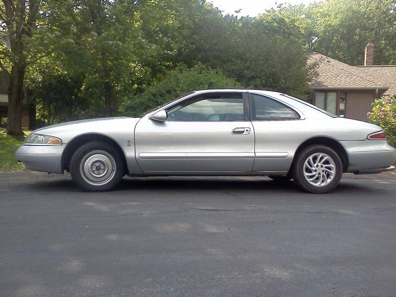

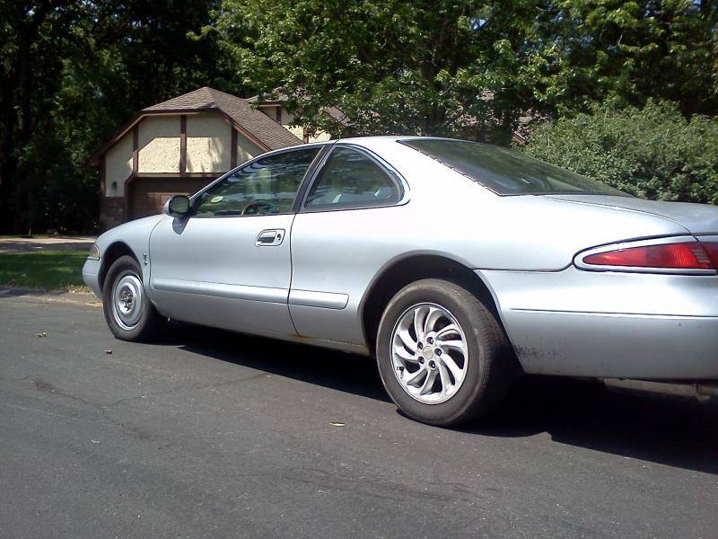

You may get decent launches with the stock SC springs, and the 4x4 ride height that you have now may even help a bit, but my SC launches fine with H&R's. :cool:
If that is the case, the ride height will stay as is for now. I am almost tempted to get some slicks and take it to the track "as is" prior to the dyno tune and potential underdrives just to see how it is. <thinking> :shifty:

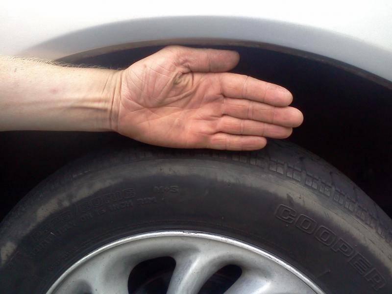

If that's the case, I would go with a taller slick, better traction and it will at least fill some of that wheel well gap..
In the process it would kill his gearing. I hate the way it looks on stock springs but honestly they do seem to work very well for drag racing.
-Alan
Glad to hear you're happy, Kirk. Hopefully you'll get the 60' you're looking for. As said above, the ride height will settle some as you put some miles on it. Ditching those poly isolators for a set of stock rubber isolators would lower the ride height significantly as well.
