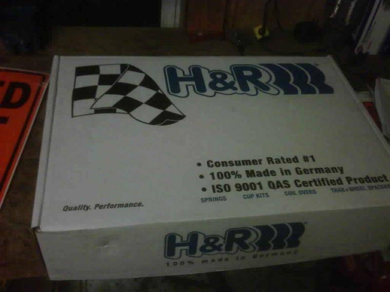

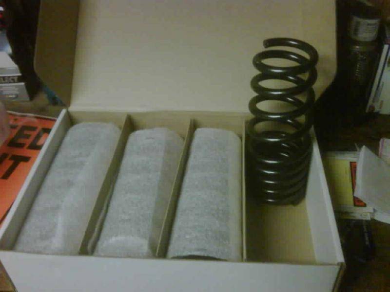

H&R Sport Spring Set Front and Rear fitment
for 2000 Jaguar S Type V8 Sport Pkg Special Order 1 $278.00 $278.00

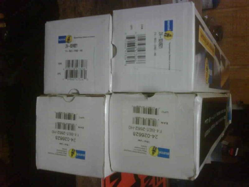

Bilstein HD Shock Front fitment
for 2000 Jaguar S Type V8 Sport Pkg Special Order 2 $121.00 $242.00
Bilstein HD Shock Rear fitment
for 2000 Jaguar S Type V8 Sport Pkg In Stock 2 $91.00 $182.00

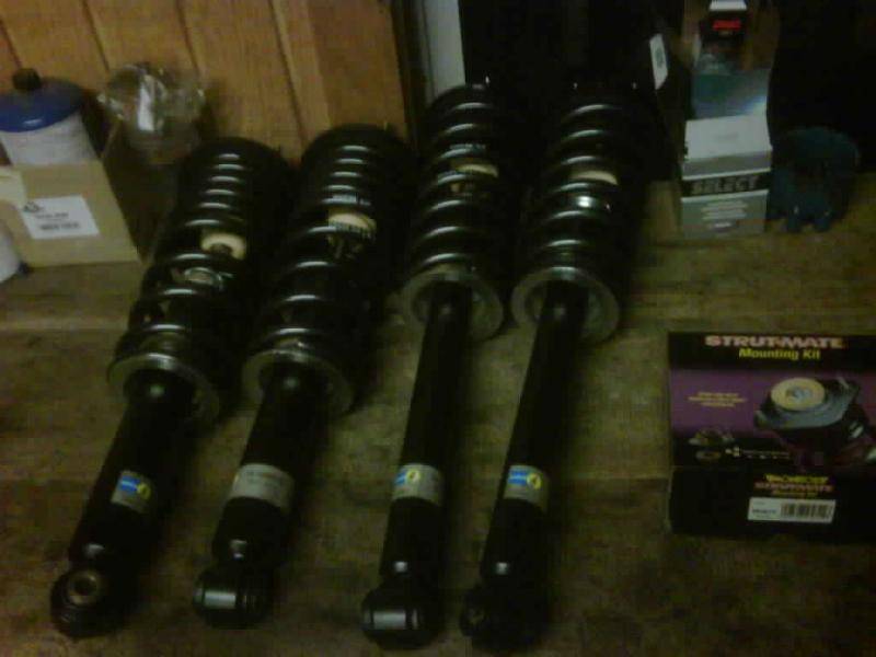

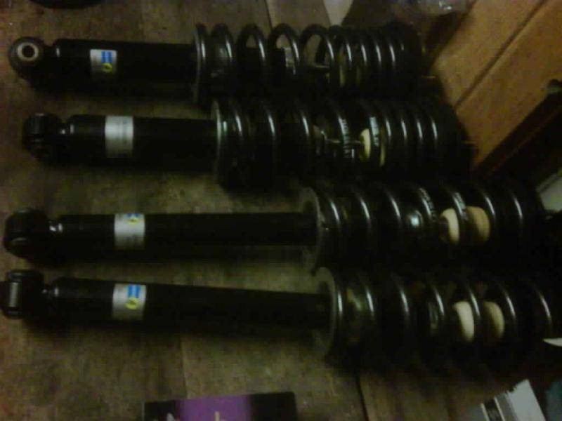

Well they were on back order but they are finally in. I also went a head and ordered new strut mounts and bumps. Might as well go all new. just dont know if i want to put shock covers on them or not.
Put them together lastnight. Hopefully Install this weekend!!!

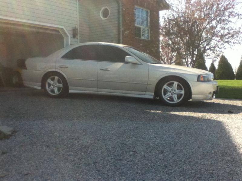

Well slapped them in yesterday took about 2 hrs total. Took some pictures but it was getting dark out. Its to hard to see the difference, but when i get back from my vacation I Will post some good pics
Any initial impressions on the handling or ride?
My bad. Down here we don't have seasons. Just hot and not hot. The latter of the two lasting only about 4 months on average.
Ride Difference is not as smoth as before, but I didnt lower the car for a smoother ride lol. I havent done to much to see if handling changed much my storage tires are a bit crappy I think 1 rim is bent. But there are good enough for storage and they fit the with Wilwood plus she needs an alignment still.
Last night I upgraded my 28mm sway bar with the 2003-2006 upgraded one so hoping the bigger sway bar makes a difference too. I am putting my 19s on tonight and have an alignment appointment for tomorrow after work. Defenitly a good idea waiting a month before doing the alignment looks the front end went down some more since day of install. Back hasn't really changed.
Also one thing I did notice was that with the stock 17s on it does rub somewhere if the steering wheel is cranked all the way right and left.

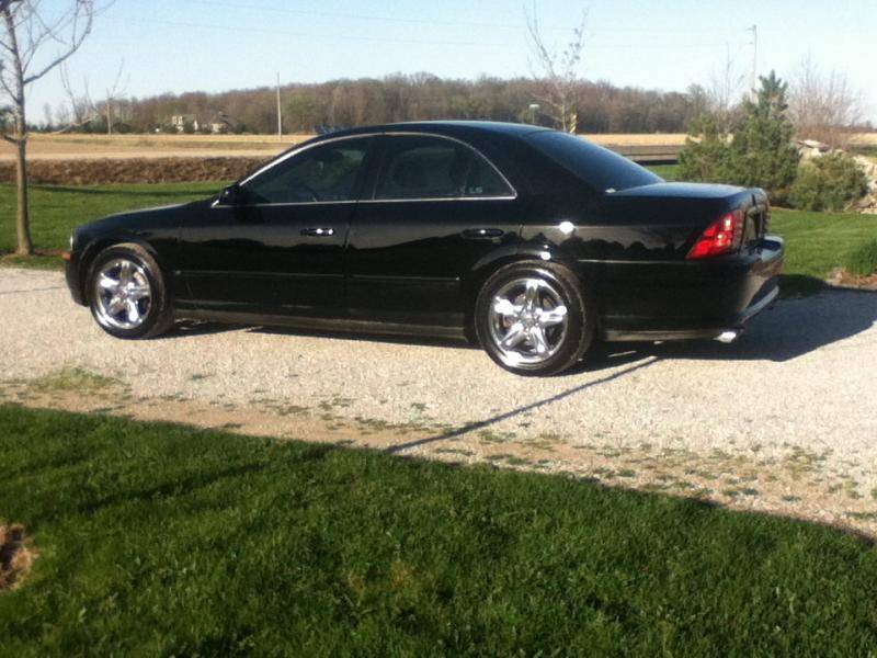

pics

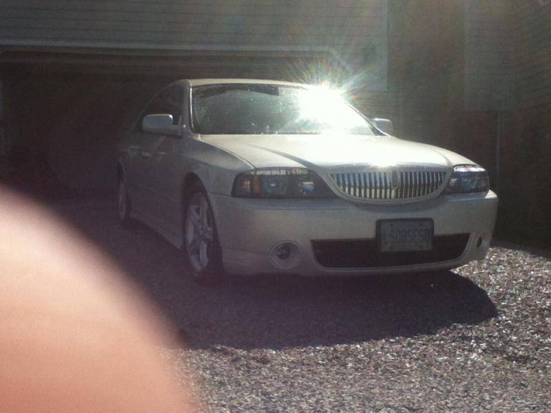

This is my black car which has new struts and is sitting at stock hieght and the Lowered LS. Keep in mind the white car might look even lower with the LSE side skirts. But there is a noticeable difference getting out my legs are use to going down farther.
The picture with the 3 Lincolns (have since sold the silver one and am down to just the 2) is BEFORE it was lowered.
I think I'll go this route when I do my suspension rebuild (after I move or they re-finish my road). Very nice looking.
Believe it or not, but my car use to look exactly like yours Hawk03. Same rims and everything right down to the chrome strip on the front.
I thought it looked similar in color and it looks good with the LSE kit. After 8yrs of owning my car I'm finally starting to make some changes to it. I doubt if I do bumper swaps or anything but I am starting to look for some different wheels and possibly lower it. Of course this is after I get all the squeaks and clunks sounds gone :).
