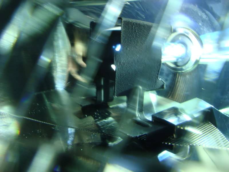

The mushroom thing you are referring to is the refractor. You never wanna remove that or you'll be blinding everyone. Gen 1 is different than Gen 2 but people have asked that same question about Gen 1 low beams that have the refractor and the HID housings also have one and it too is chrome if you're looking at it from the front and has a Lincoln emblem stamped into it. Mine are halogen housings but were new out of the box right at 2 years ago. I have a close up pic of the refractor but that's something you never want to remove. On halogen housings, it can't even be seen unless you're looking at it up this close.
On HID housings, they had to make them chrome because they could be seen easily from the outside of the car.They had to make them look good so the Gen 1 has a square one with the emblem stamped on it and the Gen 2 is a completely different style all together. A lot bigger so they gave them the mushroom look, as you call it.

The refractor itself is made into the housing. It's not going to move unless you cut the housing open and remove it. Not sure about Gen 2's but on a Gen 1, the high beam has no refractor. Only the low beam and should be the same for the Gen 2

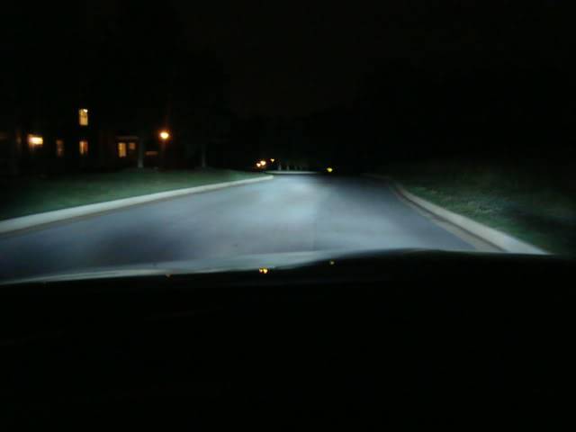

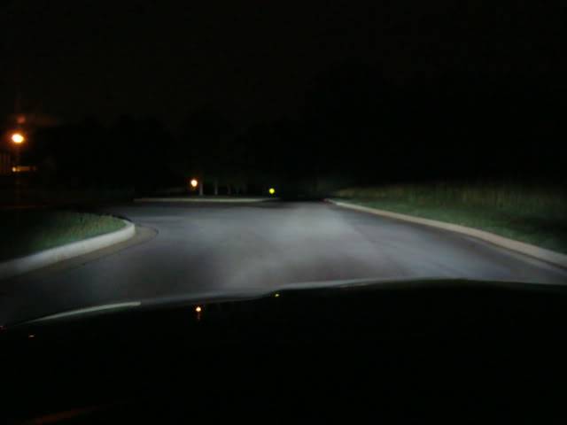

I have different sets of bulbs to play with because they're cheap. Right now I have 6K low and 10K high. I have some 12K in a box and some 6K in a box. 12K is almost Barney purple. I took these out ASAP!
12K lows
8K lows
6K lows
