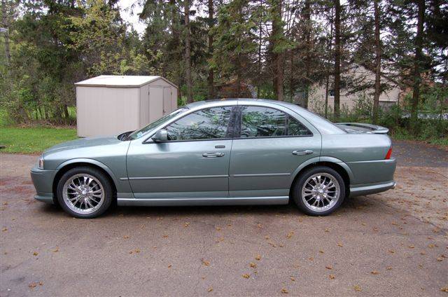

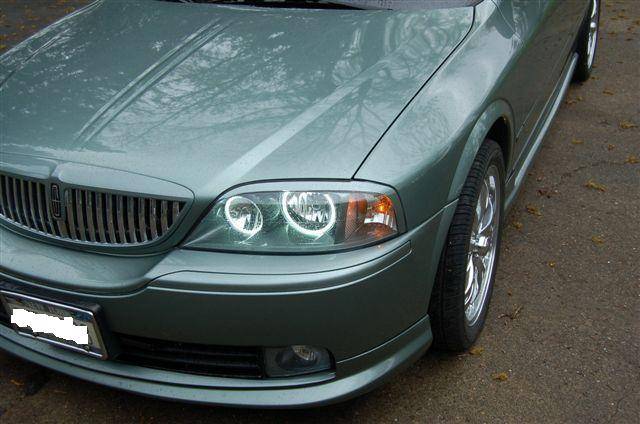

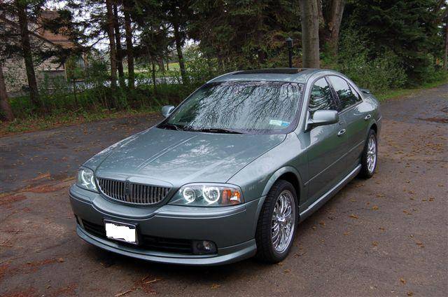

Just Put in 04 Angel Eyes with HID

We didn't discover that 1 was HID and the other Halogen until they had them apart.
This sentence is very intersting to me...
So you have one factory HID housing and one halogen housing with an HID kit, correct? What's the cutoff pattern look like on the halogen housing vs. the HID housing? I would think that they would look different...
Awesome point justin. This might put to rest that argument!
I've only driven the car after daylight once since I got this done so I haven't had enough time to evaluate things.
Now that I know where and how to cut the lights apart I'll do this myself with my original Halogens who's warm light I actually like more than what I've seen with the HIDs so far.

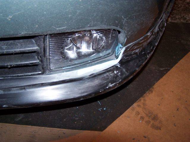

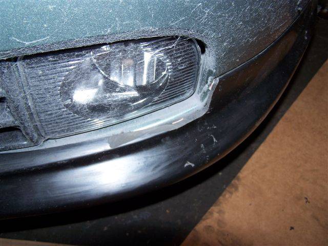

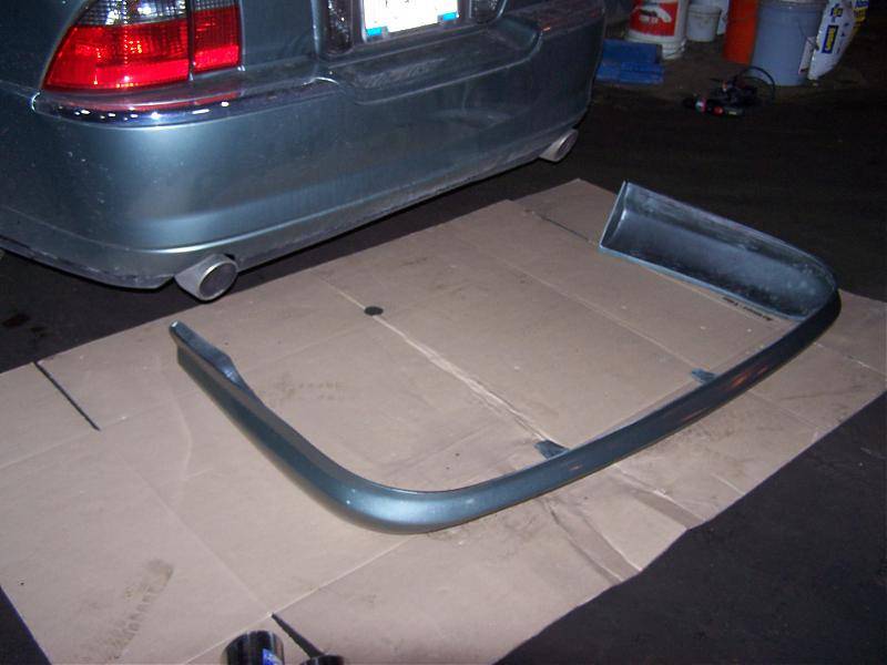

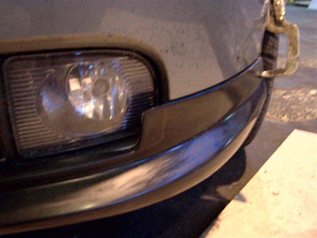

Is that an 02 ww skirt kit cuz ive been trying to find one for my 04

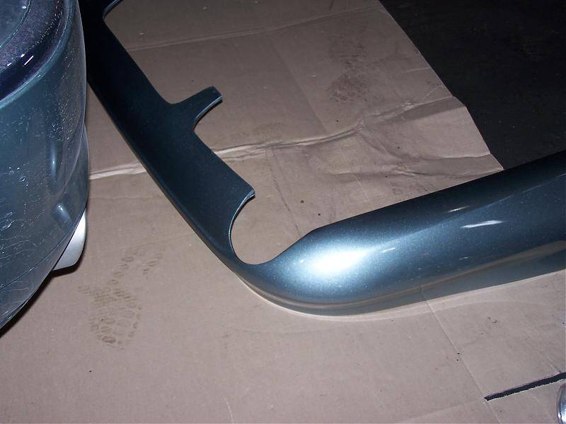

It's an 02 ww kit that I modified the front airdam and rear valence to fit.

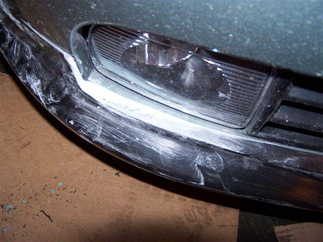

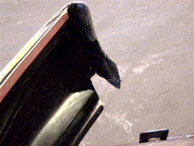

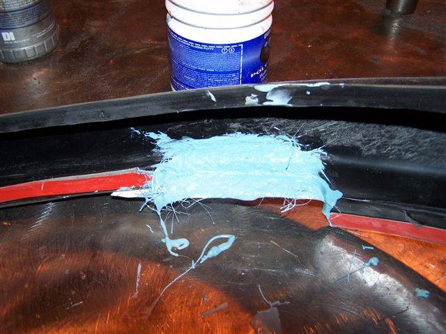

Part of it has to be trimmed and then some part built up as these pics show.
On the rear the holes have to be cut with a dremel tool for the straight 03+ exhaust tips which also need to be extended about 2 inches.
The side skirts are the same and replace the factory plastic rockers.
You also have to cut the front air dam like in the pics where it meets the fenders so it will clear the front valence which ends slightly differently where it meets the wheelwell than the 02 model.
There's some more pics of the WW kit in the Post Pics of your LS post from a week or so ago.

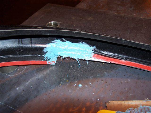

The pic of my headlight sitting on the trunk lid shows how blue it was with the next pic showing the bezel repainted by me in a matching green.
I didn't ask for a paint refund because I'm 50 and extremely well off. Ya I was p i s s e d but let it go.
Now that I saw where they cut them I learned to do this myself and it's not hard at all. I ordered an extra set of rings so if a ring was to fail I could change it out myself.

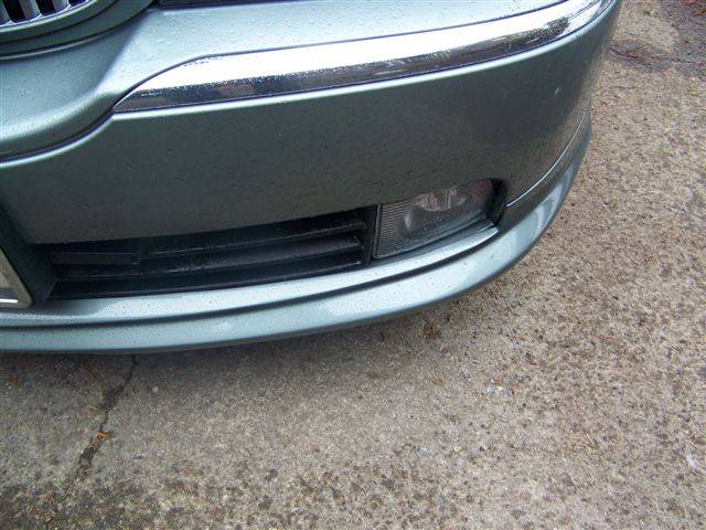

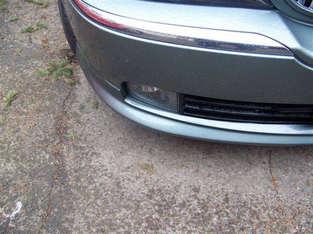

I took the wheelwell and rocker chrome off. It was just the stick on stuff.
As to filling in the bumper trim, the car came with color matched and I had the chrome trim put on when I bought the car a year ago. It's only plastic.

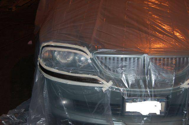

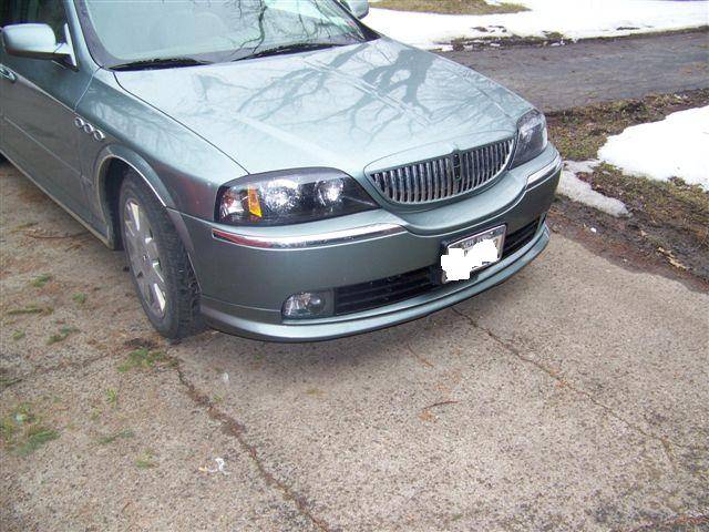

I'm just gonna paint it and the black part of the headlights today.
Too much work to fill it in and refinish for slight gain.
I think it would be major but thats me. Dint listen to me anyway:D . I don't like body kits that have not been filled in and puttied and painted to the car either:D. The cars looking good anyways and I know I would like to see it finished.
Good luck!

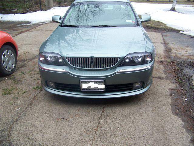

Ok,

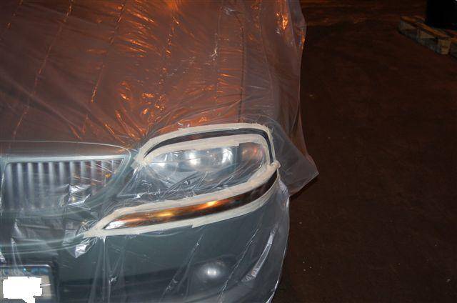

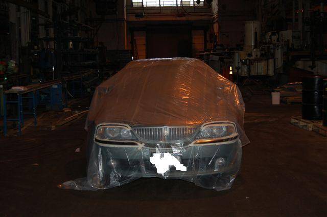

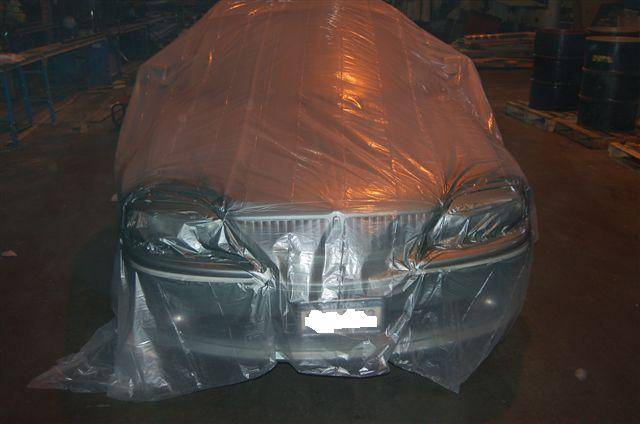

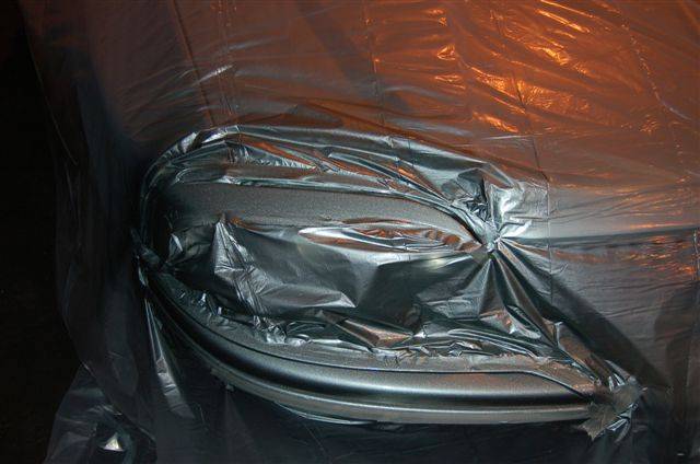

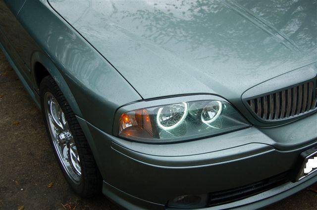

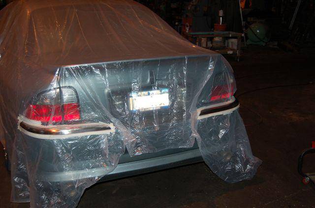

I painted the chrome bumper trim and the black one headlights at the plant today.
Like a half eyebrow.
I like it better than a full eyebrow.
AND....
I finally took the fender vents off.
Used a painters plastic 10 X 20 drop sheet for the overspray.

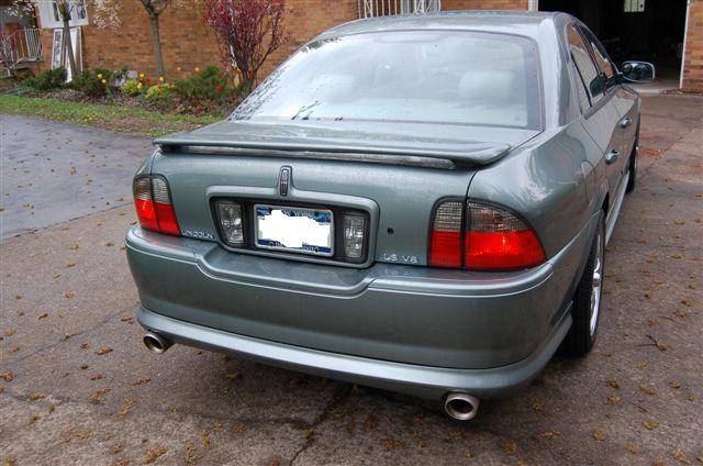

Here's some more pics although I'm thinking of getting the all red LSE tailights from Ken.
What do you guys think...
Wow, came out real nice. Thanks for removing the fender vents. Great job man.
