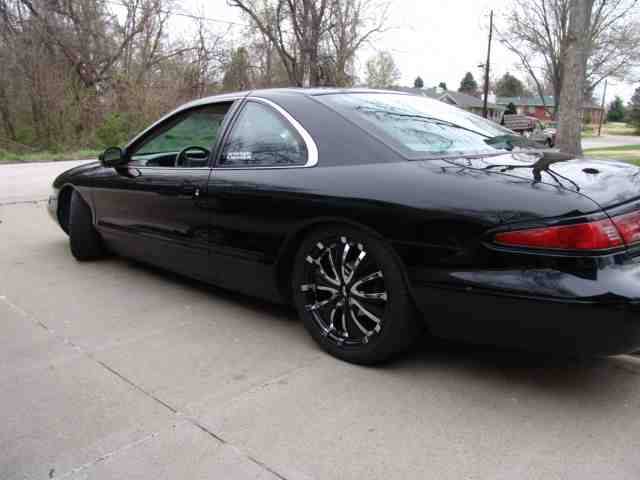

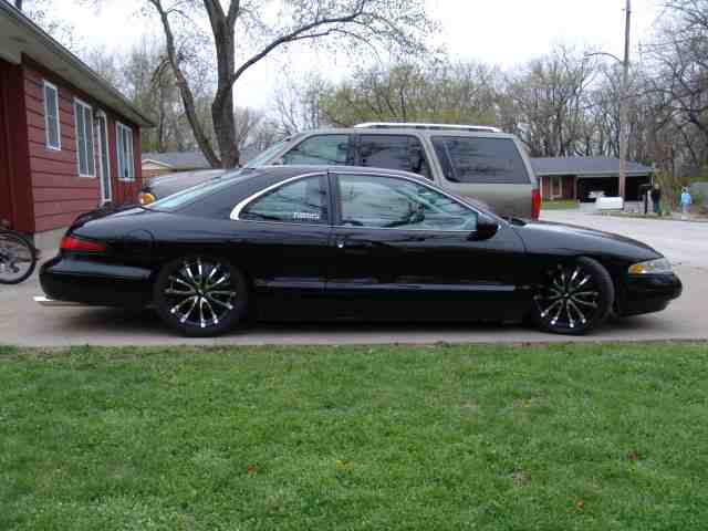

Here are some pics. Any thoughts???

Looks good, thats the car Darth Vader would drive, damn that is black!
Looks great, those wheels looks amazing on a black car, esp when its low like that, nice... ;)

It's sittin' a little too low for my taste, but it still looks good.

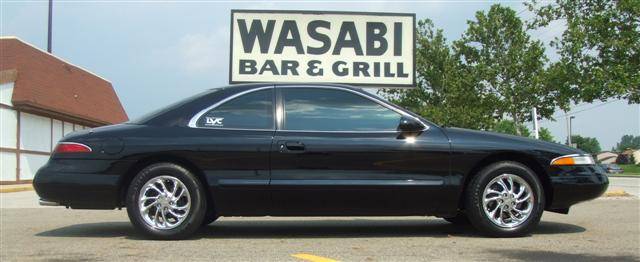

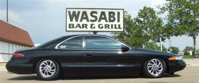

You are correct. This system only vents all of the air out of the bags. YOU CAN NOT DRIVE THE CAR LIKE THIS. Here are a couple facts you should know.
1. The front will drop alot faster than the back (engine weight). My front drops in about 10 seconds. It takes the back about a minute.
2. The car will take about 90 seconds to raise to full height (stock ht). This time will very depending on moister in the system, pump ect...
3. The car should be sensor lowered to reduce strain on the pump. This reduces the raise time.
4. As stated above, YOU CAN NOT (should not) DRIVE THE CAR LIKE THIS.
This system is a "pose" system only. This is great if you have your car parked at a show and want to slam it to the ground for looks. Great kit that is very easy to install.
Oh, you can drive the car bottomed out. But I wouldn't do it fo a long time. Say, if you're in a parade, slamming the car and driving it slow you'll be fine. But I wouldnt drive the car bottomed out all the time, and sure as hell not on the highway.

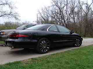

Damn!! I have to be honest. I actually thought these rims were awful when I first saw them, but lowered and blacked out I must say this is pure evil.
Axe the tips (stick way too far out imho) , tint the windows and do the headlights and you have a 100%er.
