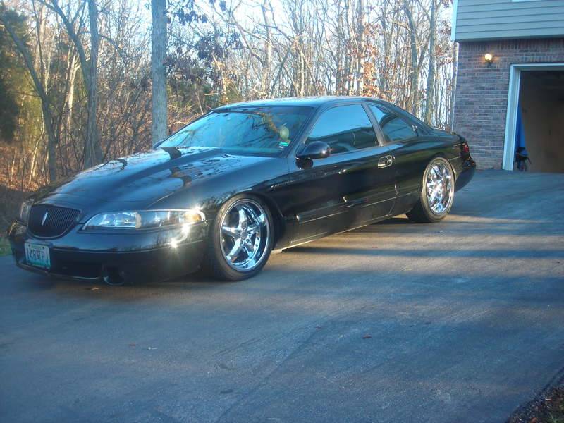

It is not worth dropping the car for a photo and weakening an already challenging system.
Install sensor height adjusters etc to lower it for appearance (within reason)but don't deflate the system except in extreme emergencies, and if possible, don't let the vehicle weight rest on the bump stops but instead block the car off the ground at or near ordinary ride height.... if you want to treat the car properly.
