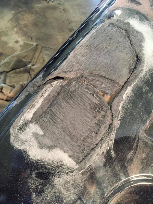

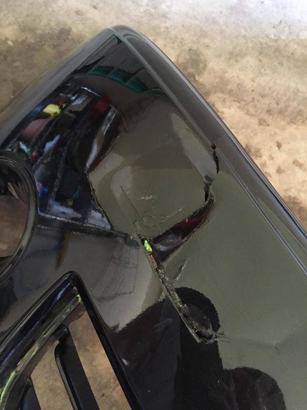

I have a lot more photos, but my phone won't let me upload anymore. Going to have to wait until I'm back on wifi tonight.

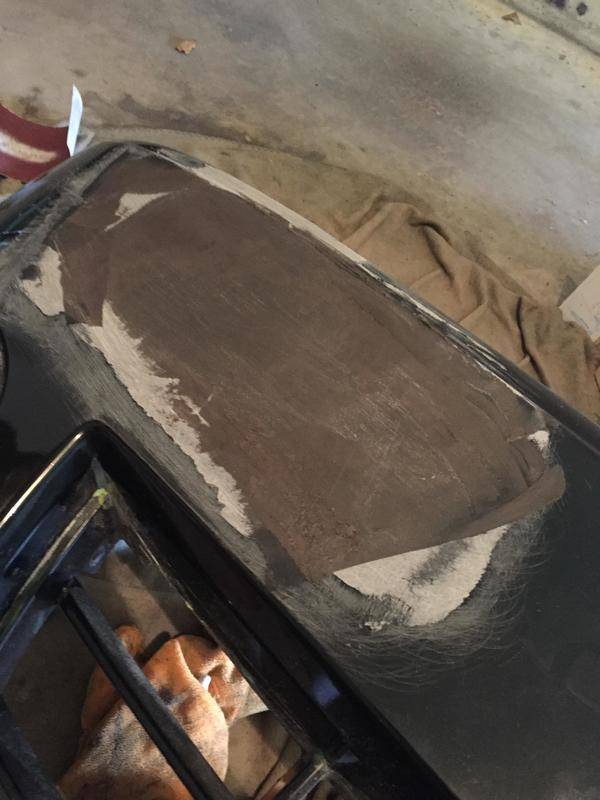

The bumper is finished, just need to prime and dip.

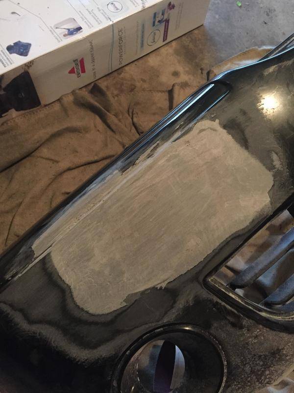

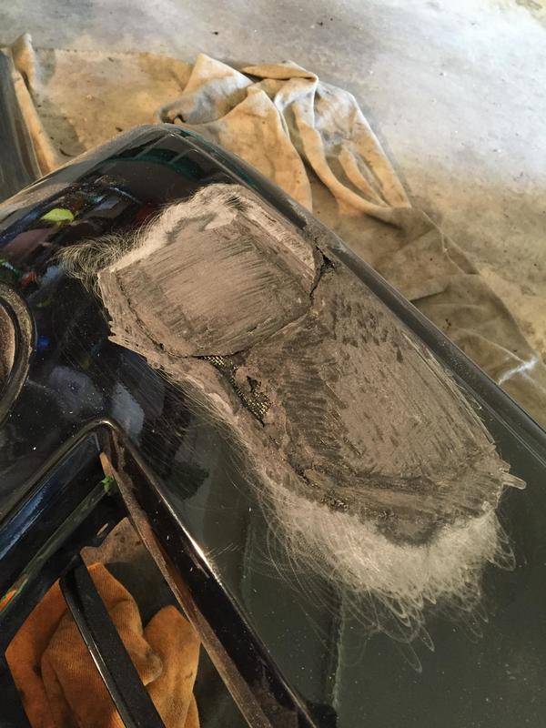

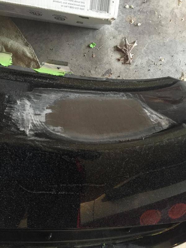

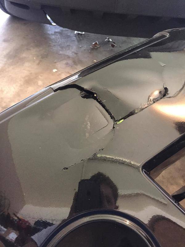

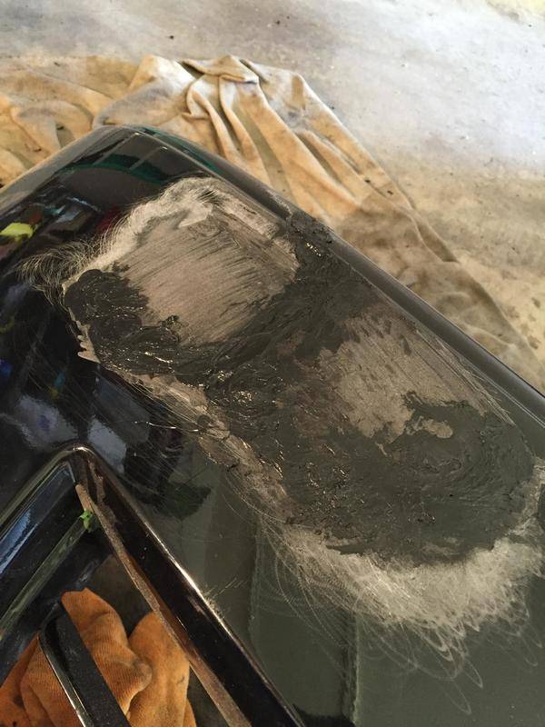

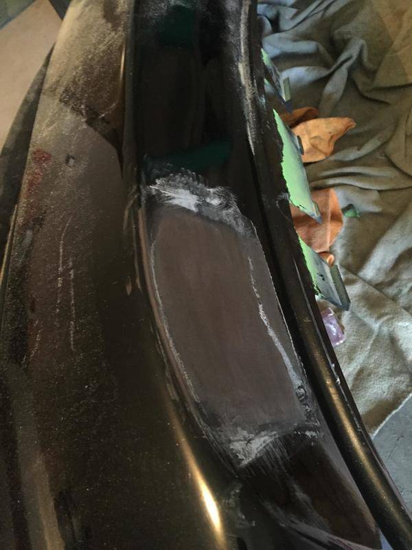

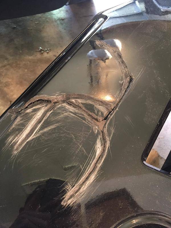

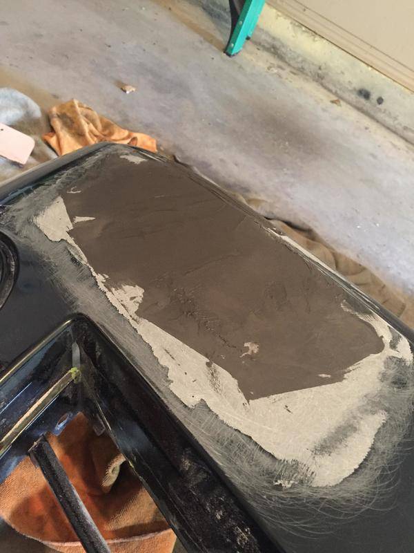

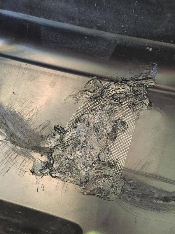

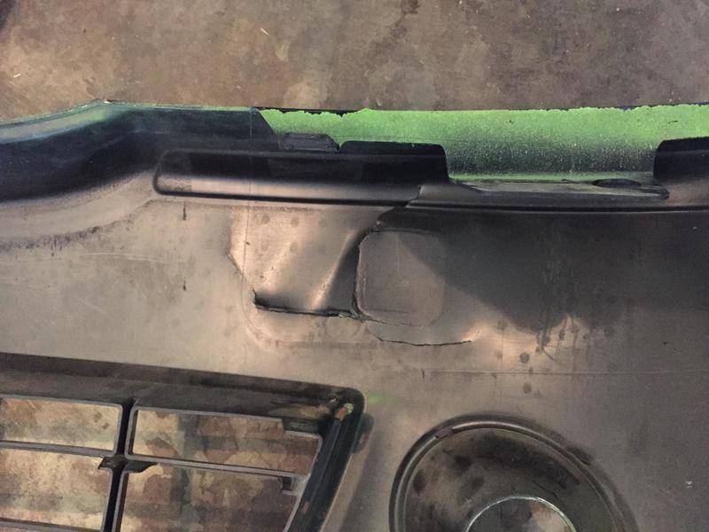

Greer progress. I've heard of plastic welding before but never looked into it. I think Pektel used it to modify something in his glove compartment. So basically melt plastic over the missing area, sand down, fill remaining defects with bondo?
Yea basically you get a welder and plastic rods that are the same plastic material as your project, then melt the rods into the seams. Apparently a lot of body shops are doing this now. It is incredibly economical. I bought a pretty nice welder since I am a hardcore DIYr, so mine was more expensive ($160), but it has temperature control for the different types of plastics. There are some cheap ones out there that are just one temp (usually too hot) and can still get the job done from what I've seen on Youtube.

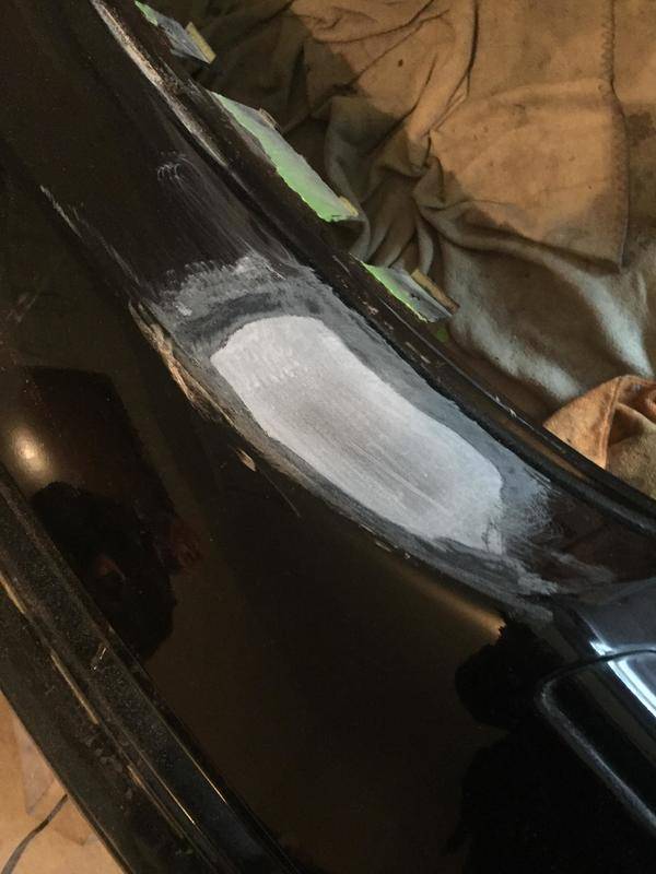

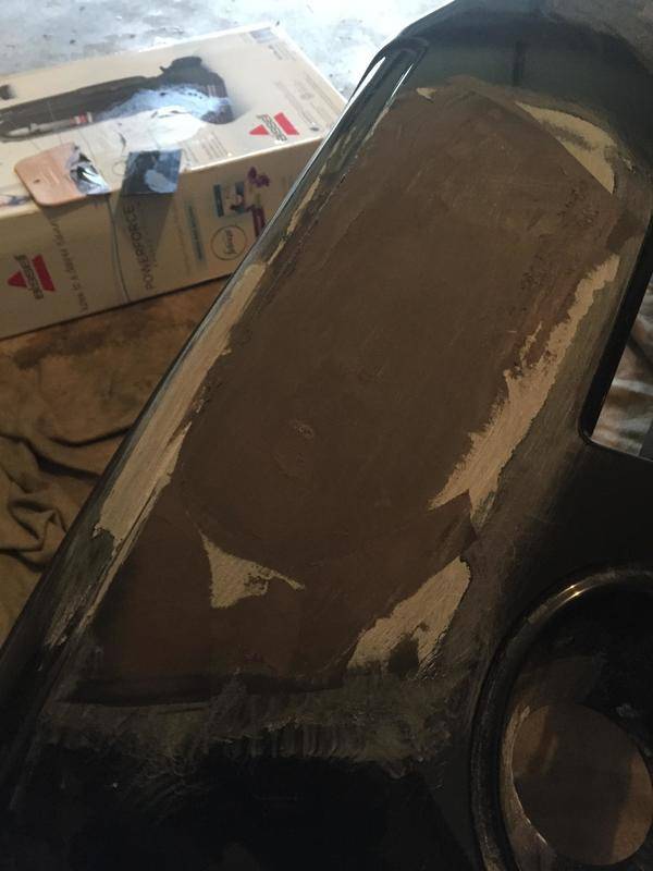

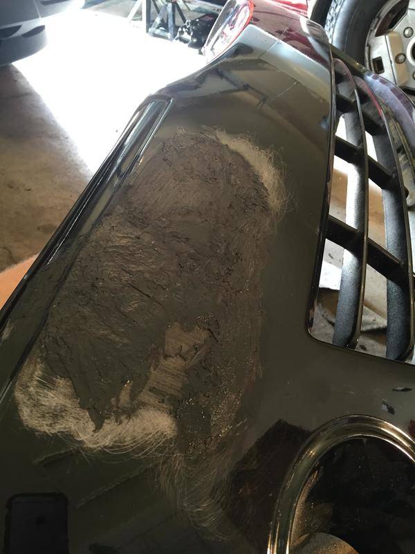

And yea, basically weld the cracks together, then I had to build up an epoxy over the area to bring it level with the rest of the bumper and fill in the imperfections. The epoxy I am using is called U-POL 706, it is fast setting and flexible when hardened, so it is basically instant plastic. Also it has very nice sand-ability and can be feathered out for finish without any glaze.

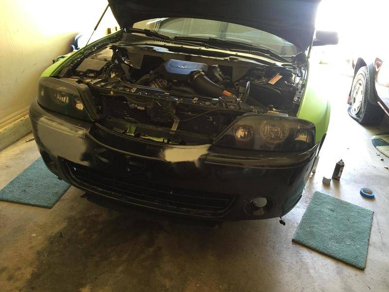

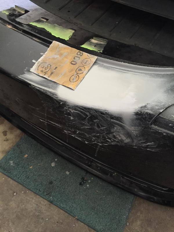

Wet sanded and installed. Ready for paint this coming weekend.

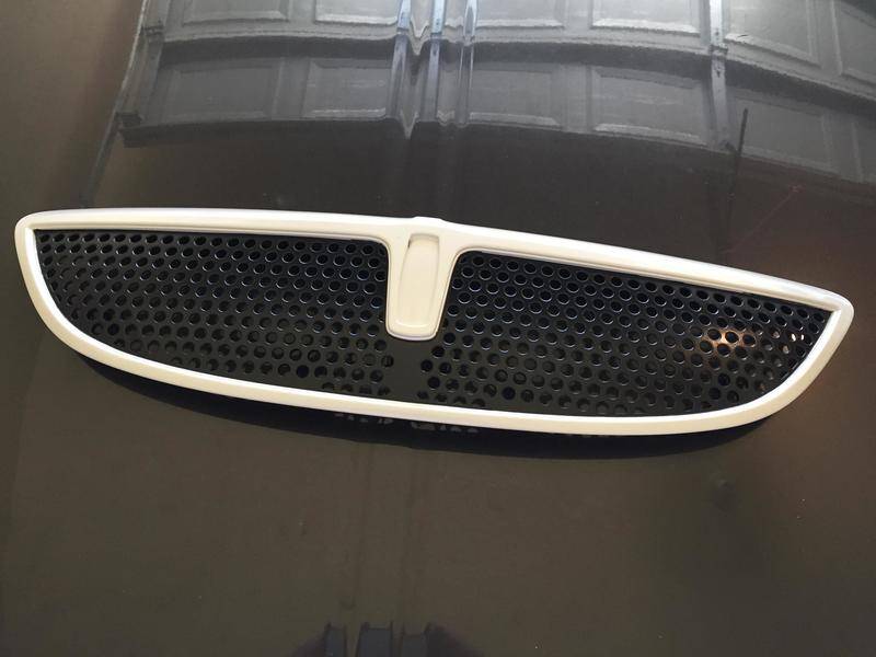

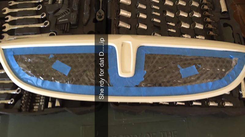

Painted grill insert and taped off for dip.
