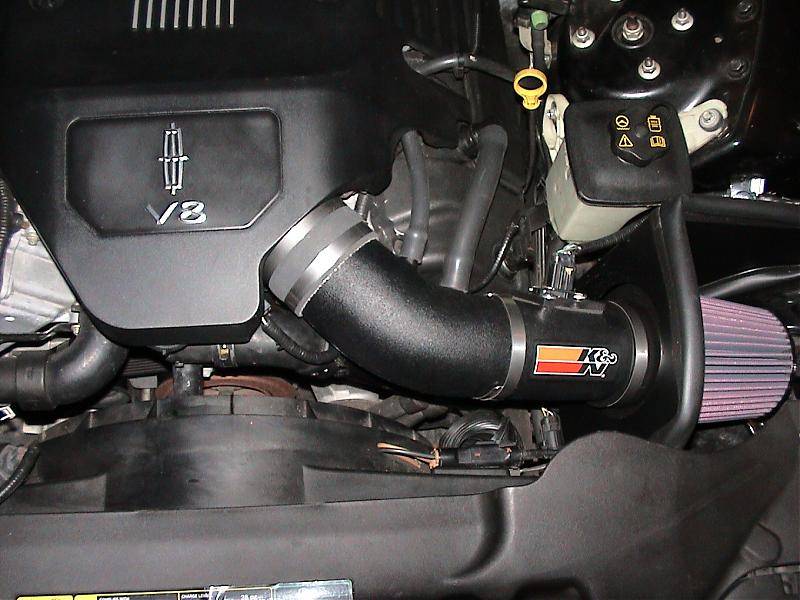

PLEASE HELP!! i just installed a k&n intake kit fipkII (the blk one w/the heat shield) on my 2003 ls v8. i paid $270 as you know its originally for a '03 thunderbird but they have the SAME engine setup. ok i installed, tested the vehicle and my nightmare started...
I drove 1/2 a mile i was driving an easy 40mph max., i heard a caution ding (like you're low on fuel, i was full) quickly looked at the info center on the guages and it read "ETC FAILSAFE MODE". OK ON TOP OF THAT. my car was still on but would'nt go over 10mph or 1500rpm, i also got a check engine. i pulled over turned off the on and it was back to normal but with a check engine, i ran again drove for like 2miles and got the same "ETC..." AND COULDNT GO OVER 10MPH.
i ran for codes and apparently the throttle body is getting too much air, the Ford dealer said the new k&n kit is throwing off the computer and its not giving enough gas where it should go. when it goes on etc failsafe mode i try to floor it and i hear a loudish thump coming from the back of the car. what does all these mean? does anyone else have this problem? DOES THE SCT TUNER WORK with an '03 ls v8.
yes, everything that my eyes can see everything is connected properly! my mechanic even double checked! should i just return the intake kit?

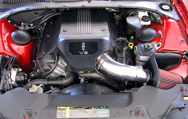

I've been running the aluminum version of the K&N intake for over 2 years now, on both a '03 and '06 LS without any problems what so ever. Have you checked your MAF sensor? Did you put it in correctly? Is it damaged? Did you check the sensor's connector and wiring?

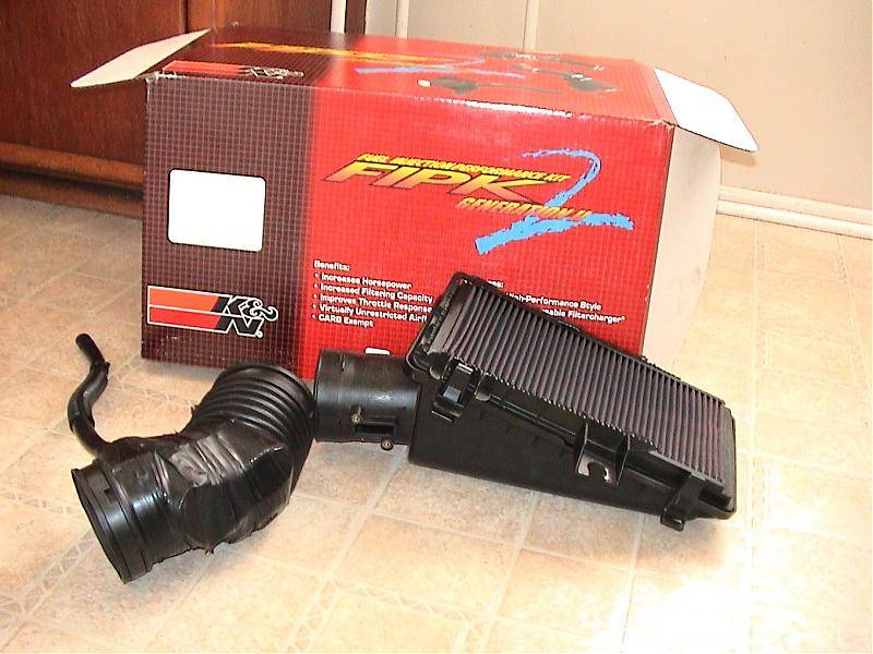

you might be right about the leak with mods i did to my stock intake (see pic.) i did disconnect the battery and 3mile i drove have been no problem. the couplers seem right and i made sure i got one clear on the throttle body and one on the tube thx.
this picture is of my stock intake with a mod i did that i read on here, which was to cut the bottom of the itake box. it worked good for a year then 1 month ago the problems i first discribed started.
So your gutted air box started the problems?
