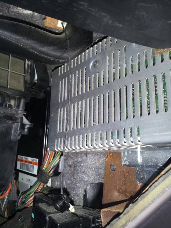

Should also be on the module itself, which is located behind the glovebox, on the right side. You'll need to remove the cord of the glove box and push the tabs on the sides inward and the box will drop down

On a Gen1 the code can be found on the SCIL (but its located just forward of the air ride switch ) Gen2 the SCIL is behind the glovebox
