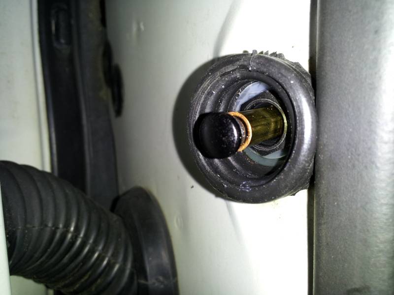

I pretty much figured this out right after I posted this..I went back out to see if it worked about 30 minutes later and once again the keypad wasnt working..I opened the door with the key and noticed the interior lights weren't illuminated and as I stood there pondering what was going on all of a sudden about 3 seconds later the interior lights came on as well as the tiny light around the keyhole lit up..so I tried the keypad and it worked..suddenly this made me think of the door ajar switch. I had problems last winter with it sticking, having to use pb blaster to free it up. So I assume this is the problem again. I'll be pulling the door panels soon when I get my new ones in the mail, so I'll have to address that stupid switch when the time comes..till then I guess ill have to use the key, oh well.

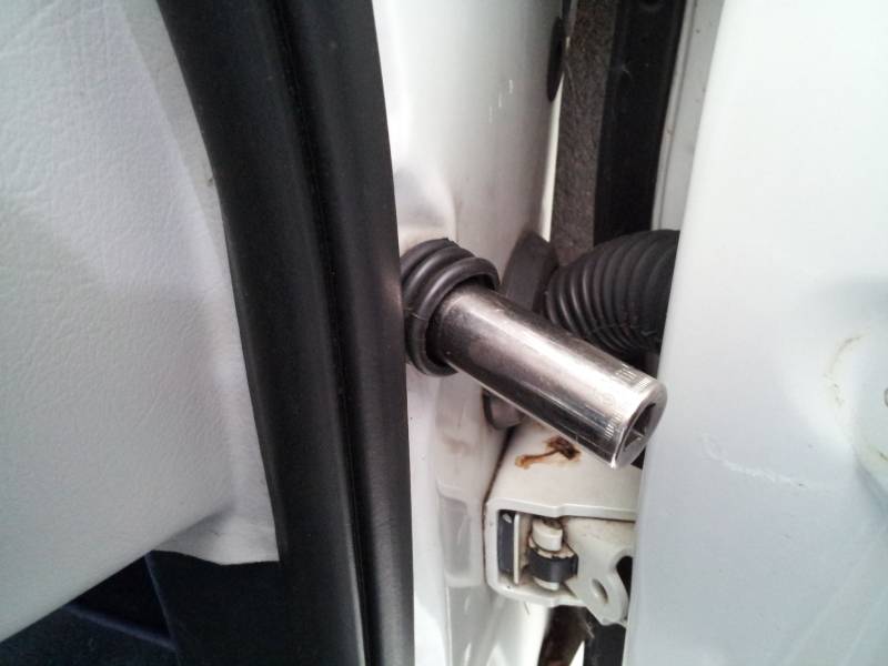

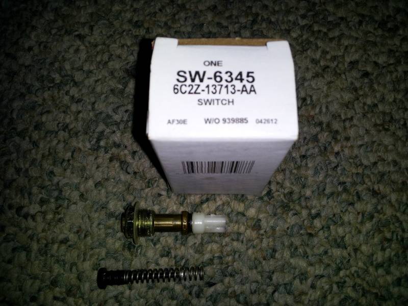

I had the random problem too but ever since I put in the new Motorcraft door jamb switches, it has been working every time since. Not sure if it was related or not but it must have been. Sometimes my interior lights would just come on randomly too. Ordered from rockauto and it's a 3 to 5 min fix or less if you have the socket ready to go. My passengers side was good but I went ahead and bought a new one for that side too just so I would know for sure that both were new.
If you can read that socket, that's the size you need. I can't remember if the drivers side had 3 prong connections but the passengers side did. Anyway, it's about $8.50 or so to the door for each switch. Less if both are bought at the same time, I would imagine. It's not like they don't have room in the box to add another switch. This is the box that the switch came in. Not once but twice!
