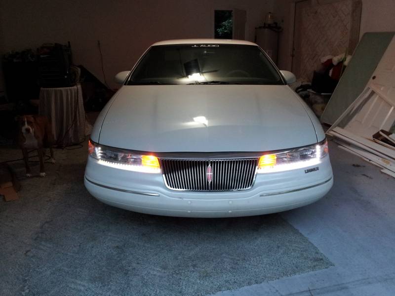

I've been seeing so many cars lately with daytime LED lights on the bumper. They look really nice, so I started to wonder what would these lights look like on the Mark? I don't know if it would look cheesy or not. There is no shortage of them on Ebay. What do you think?

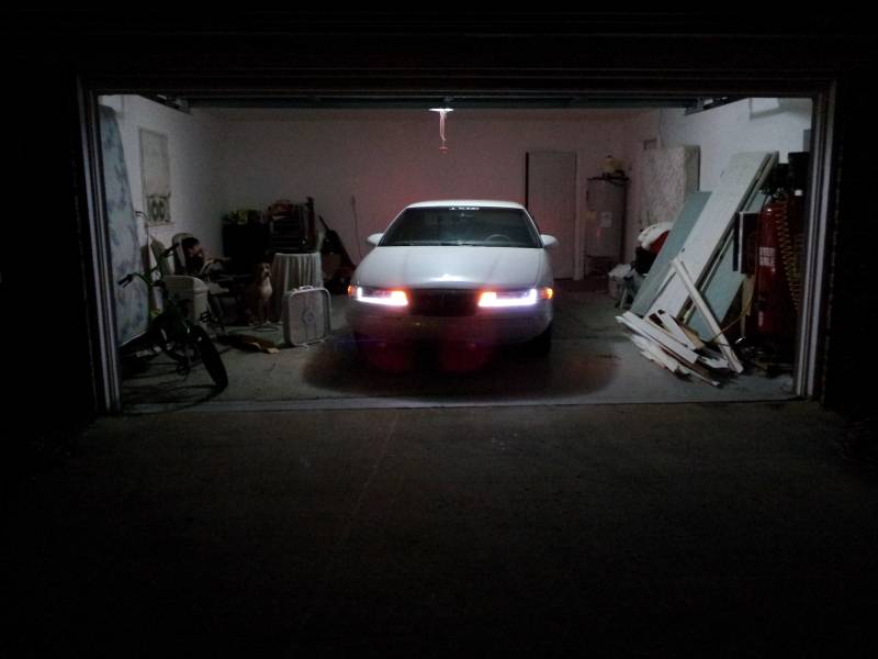

I done my headlights for $20 because I was bored but honestly, when the sun is going down, they are bright just like an Audi. I tried taking a night time pic but they are showing too much of a glare and they really don't look like the pic shows them from a distance. They really look wicked from a distance. They are "side shine SMD LED's" 24" and can be cut after every 3rd LED. During the day, you can stand right in front of it if they were off and never even see them.
Here is a distant shot but remember, the glare isn't like you see in the pic but they are very bright but not headlight bright. I think the white bumper cover is helping make the glare.

I like it. I put LED turns, markers and cornerings in my Mark and theyare bright! I'd like to see a set embedded in the trim strip of the front bumper.
I thought about it but then the rice started hitting me so I stopped at the headlights. I thought about taking out the 90 degree turn to see how that looks but it's something that has to be seen in person to really see what they look like when lit at night.

If you click the link right above, scroll down and you can see different pics of what they look like on different cars. When they are not on during the day, you really have to be looking for the strip to even see it. It's very thin and flexible and they can be cut with scissors or wire cutters after every third SMD. These are SMD LED's, not just a normal LED bulb on a strip.
I done my headlights for $20 because I was bored but honestly, when the sun is going down, they are bright just like an Audi. I tried taking a night time pic but they are showing too much of a glare and they really don't look like the pic shows them from a distance. They really look wicked from a distance. They are "side shine LED SMD's" 24" and can be cut after every 3rd LED. During the day, you can stand right in front of it if they were off and never even see them.

damn, dude that looks good, I bet if your car wasn't white it wouldn't reflect so much off the bumper and make that glare..I'd like to see it on a darker color though..I wonder how it would look if you seperated a set of headlights and put them inside at the bottom edge instead.
If you wanted to cut a set open, it would probably look even better but only with HID housings like you have and Alex but I don't think any of us want to cut open our housings for a $20 pair of string lights. I think a Gen 2 would look good because of the curve in the headlights and yes, the white bumper is helping with the picture glare but I tried getting down below where the light would reflect off the bumper and taking a pic. It's just that they're really that bright and I used two different cameras. Maybe the night time settings just aren't right. Anyway, it's only $20 and about 30 min worth of work and not permanent, unless you leave them there.
I used MAF cleaner. Sprayed it on a microfiber rag and wiped the bottom of the housing and up the side where I was going to stick them. You can use alcohol too but MAF cleaner leaves no residue and dries fast. They are sticking very good. They come with 3M adhesive tape on the back side and bend just about any way you want them to and each strand has markings on the back to show where you can cut. I would like to see others on a darker colored car too.
You have to tie into two of your three parking light wires. Mine are wired to stay on and not blink. Just pull the wire harness from the bulb socket, leaving your bulb inside the housing. Find the two darker colored wires and get the strand to light up to make sure you have the right side in your hand. They only shine in one direction sideways so you do have a left and a right. Once you have the wires stuck into the harness, take the harness and stick it back onto the socket and push it on. I promise it works and no cutting of your existing wiring. Once you have that harness pressed back onto the socket, it ain't going anywhere.

There are some that don't like them. It's also something that can be over done too. Another reason I was thinking about doing away with the 90 degree turn but before I cut them down again, I'm going to put electrical tape over the vertical part just to see what a straight line looks like. But it is something that some like and some don't and I take no offense. :)
