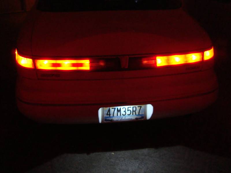

I personally think you're better off not messing with the bulbs in the rear except for the tag light (168, 194) because it takes something like a Cree LED with probably 3 to 5 watts to show through that red plastic. The normal bulbs do a better job then the SMD LED's do. I haven't tried the front parking lights yet. I only done the tag and the interior but did try the light bar on the trunk lid and they just didn't have the brightness needed to really see it. I do have them in the side tail lights, the smaller ones, not the brake lights. I think I used 194's in them too.

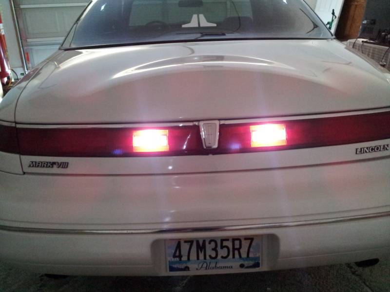

What do you have in yours in the pictures at the top? Isn't that all of them replaced with LEDs?
No, just the tag light with one 194 and the small bulbs in the outer tail lights have 194's in them too. The rest are just normal bulbs.
The reverse lights too but that's all the LED's I have in the rear.
Ohhhh. I was counting all the bulbs I could see from the picture lol. They looked really bright, I thought they were all LEDs.
I'll get another pic tonight with a better camera because they do look a little bright in that pic but it's close. I did replace all the normal bulbs with new ones when I added the LED's. I had one light bar light burned out and didn't know so I made all of them fresh again. The 5 SMD LED's just weren't cutting through the plastic like I thought they would but I bet a Cree LED would. Thing is, they project light and it might look like a spot on the plastic when lit. I haven't tried one to see yet.

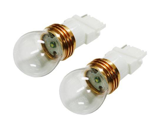

Cree leds are what you want for the reverse light they project more of a beam I Believe and are much brighter, I want to put cree in mine but not sure how long the bulb can be clearance wise.

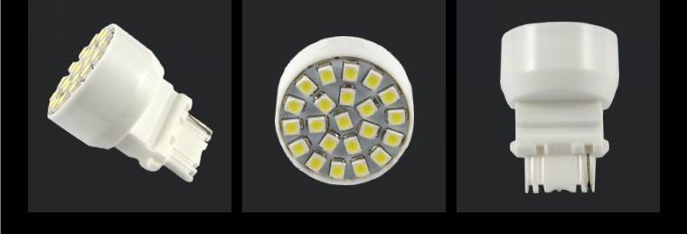

Something to keep in mind when buying LED lamps is the number of actual LEDs in the bulb. The lamps with
LEDs in all directions will light up the reflector as well as the lens. But more is definitely better in this case.

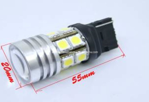

Cree LED's have one big led on the end for a straight beam, and sometimes both a few on the sides and big one on the end.
S25-3156-3157-High-Power-CREE-LED-Projector-Bulb-Reverse-Backup-Light-12-SMD-Flash-LED.jpg
These look like they would work too, just a tad expensive:
