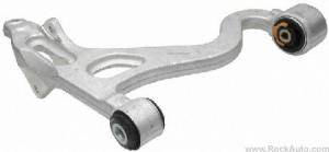

Pretty much. If you had a front control arm, could you develop a bushing for it also? What I'm thinking about doing is going to a salvage yard and getting a front and rear control arm, lower. That shouldn't be too expensive.

The lower control arm can be purchased for 196.45 per side and that includes bushings.

Not control arms, just Delrin Bushings for the control arm.
It won't happen until I see either a complete car or some control arms.
I had spoken with someone at energy suspension and asked about control arm bushings. he told me the best thing to do is to get the ID/OD of the bushings and check their universal bushing sets and find the closest one. He also mentioned that if I can not find it that I could go with the size over and have a machine shop turn them down with a lathe to fit properly, he also said that they have a preload to press in. I have not needed to replace mine yet. If anyone can get the size I'll check it out and also see if they can make a kit for the LS.
Yea a lot of us well at least I have, figured that out. The thing is getting a hold of some spare parts to measure them and check against their stock. I was thinking about seeing can I buy some used arms for cheap and do this.
