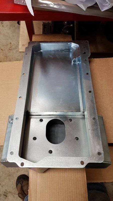

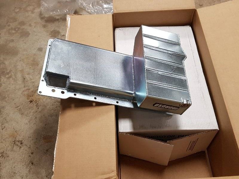

Nice work do they allow for much adjustments? .... here is the pan I have to use on my engine swap.

The part number for the pan is moroso 710-20138 it’s a made for the GTO

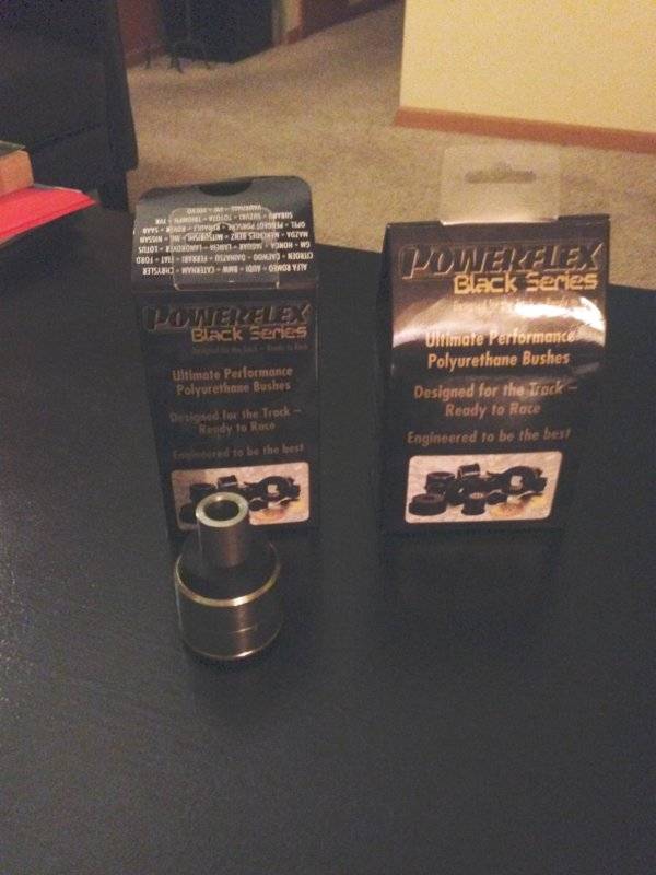

I rebuilt my rear lower control arms with PowerFlex bushings. I used the "black" series which is 90% stiffer then stock. I have had the bushings installed in the control arms but haven't installed the arms yet since it has been so blistering cold out, hopefully here soon!
Is this an ls pan? If so I would love a part number!
Oil pan is moroso part #
Mor-20138
Pick up tube #
Nal-12572654
Pan gasket #
Nal-12612350
Wimdage tray #
Nal-12558253
Dipstick #
Mor-25973

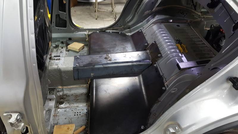

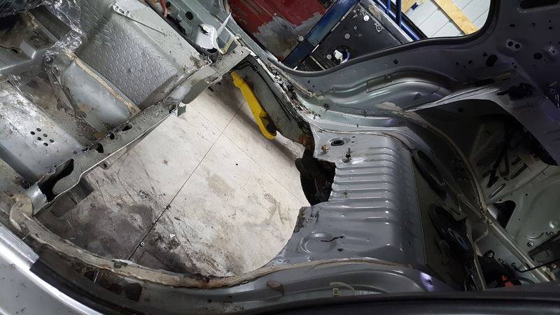

The decision was made to run a fuel cell after fitment of a racing seat over the stock tank was deemed impossible.
Cut out the wonky sheetmetal outline from the stock tank and will replace it with a straighter shot of metal.

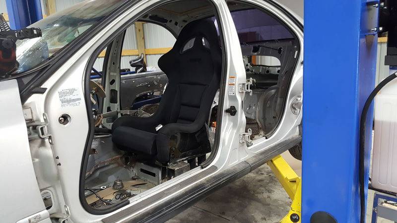

Got my seat mounted with some practice in welding on the LS sheetmetal.

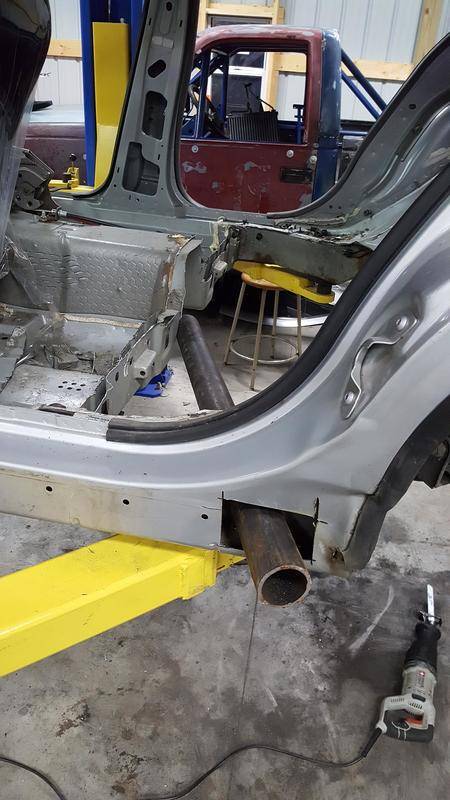

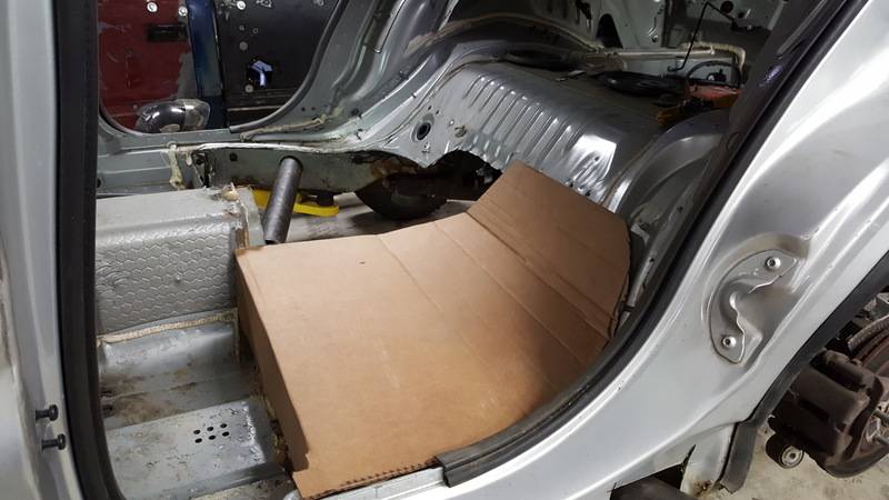

Made some removable pans so I can service my sidepipe exhaust and or driveshaft. 14 guage steel.
Got the exhaust routes through the frame rail. Cant wait to hear these sounds. Also picked up a t56.
