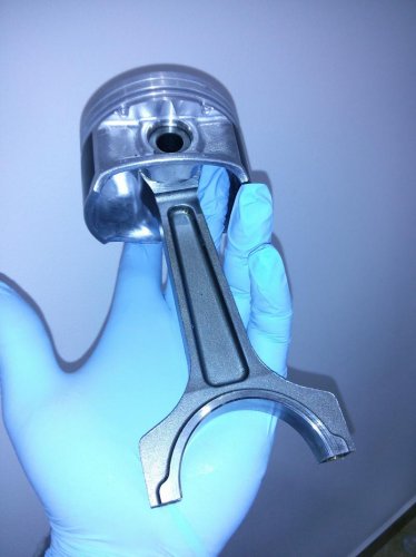

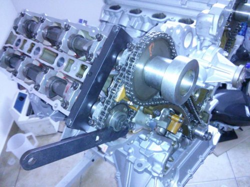

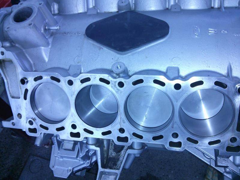

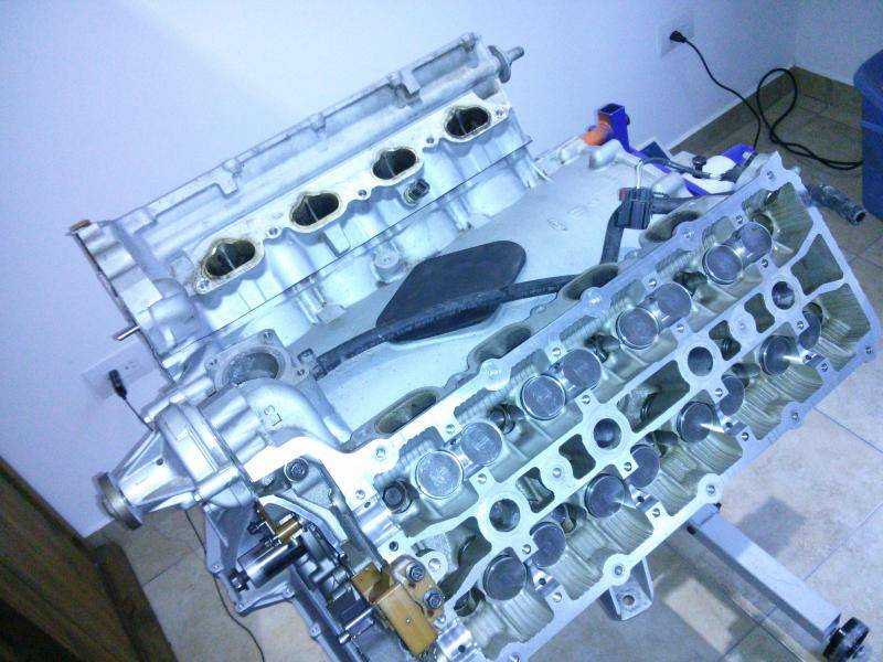

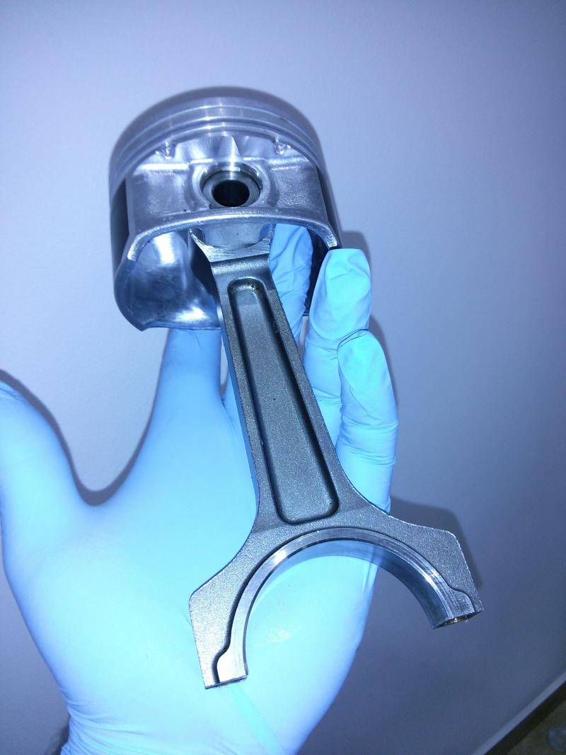

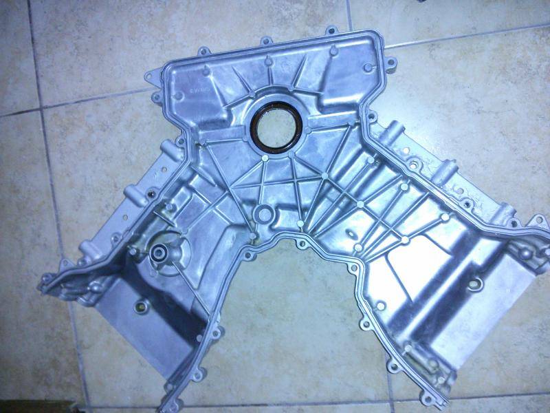

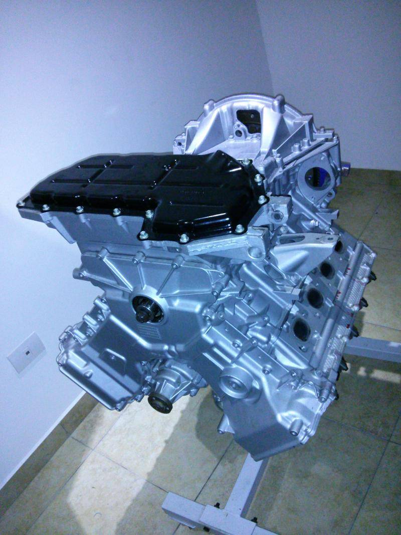

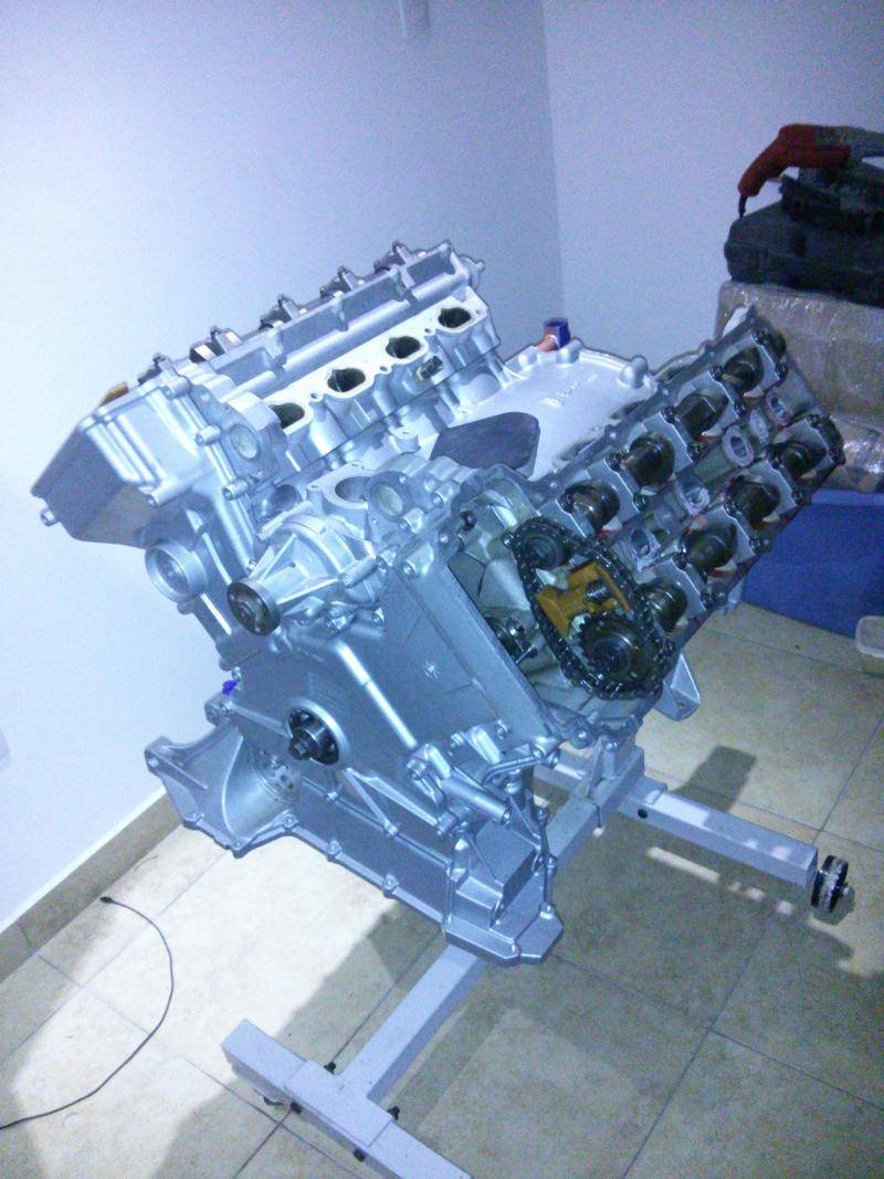

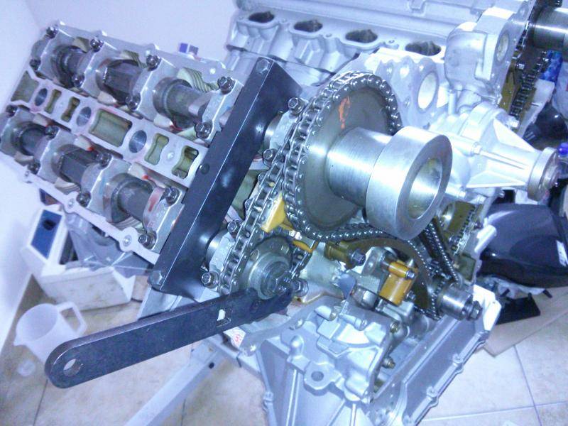

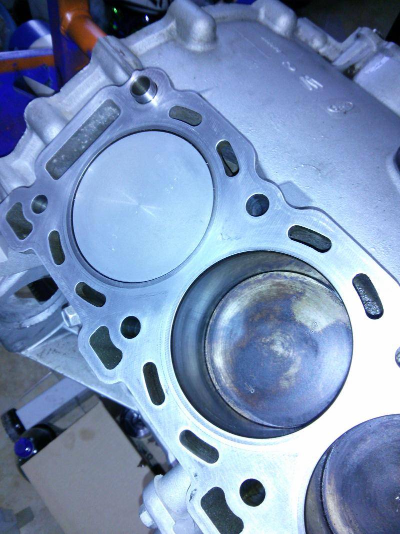

Hi guys! It has been a long time since I last posted, but in with some news. Already rebuilt almost the entire engine, checked valve heights, new piston rings, gaskets, etc. I thought it would be ok to share some photos. Did a cleanup on the engine internals and finally was able to restore compression on the engine.
IMG_20130516_105439.jpgIMG_20130516_123036.jpgIMG_20130517_175428.jpgIMG_20130518_021117.jpgIMG_20130518_205101.jpgIMG_20130519_115855.jpgIMG_20130519_122336.jpgIMG_20130527_163714.jpg
A+ on the cleaning. Looking at how shiny the block is, I'm guessing there was some soft blasting (like walnut or corn husks) and dipping involved. Looks cleaner then a lot of factory crate engines I've seen.
So when you took the engine apart, there was actual build up or something that caused a failure? And what did you do about rod/main bearings on the crank? The bottom end on the LS 3.9 always seemed to be the gotcha for doing rebuilds, although it looked like it was the same as the 4.0 Jag blocks with the exception of the piston rings (Nikasil vs Iron bores)
nice.
those look like the old style secondary tensioners though.
there is a newer style, and since the engine is out and everything, i'd be replacing them now.
Really cool to see the engine all cleaned up like that. Thanks for sharing!
