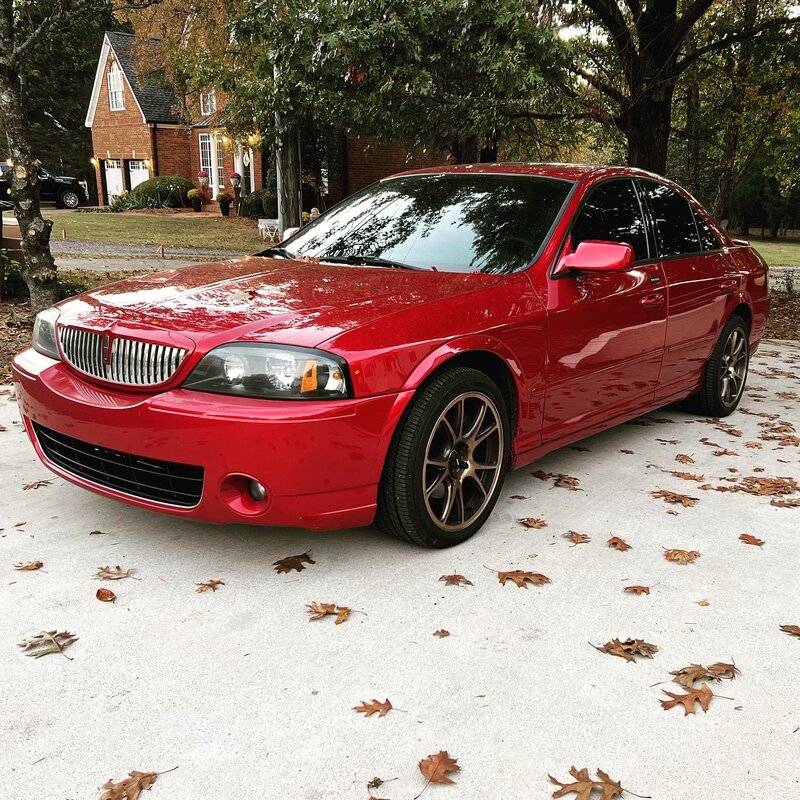

Oh that's a beautiful LS!I have a gen 2. It’s a o6View attachment 828577440
