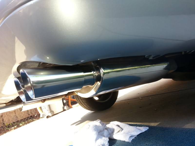

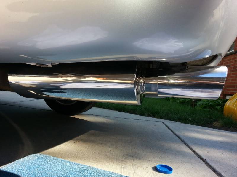

Lincoln motorsport mufflers installed!!!!!!!!!!!
I love it. It think it suites our cars great. Sounds clean, not rough. Just right. Only reason I haven't ordered a set is because I don't like those dual outlets on each exhaust. Well, that & after the respration of my blue on black, I'm completely out of budget. Who knows what the winter might bring my way. Christmas 2012 I'm asking Santa for a set.
But...they look awesome all shined up,
I had just hacked off my mufflers and kept stock tips on my LSC but I want bigger pipe and get rid of the third cat. Put an x-pipe. I'm looking for that cobra sound or as close as possible. Might go catless and run x-pipe resonator.
^ I plan 2.5 mandrel from the cats back with a dynomax ultra flow x dual in dual out in the centre and pipe all the way back to stock 2013 mustang gt tips.(free score from work :D)
Time for some headers on that sucker and let it scream. :cool: I love drone. You anti-drone folks can keep to yourselves. :p I like feeling the engine talk through every bone in my body. :D
I am not sure what this drone stuff is people talk about ? How does one know if they suffer from drone. What if one suffers from drone but doesnt realize it because drone is awesome to suffer from. meh. my stereo is to loud to even know if i have drone. but if i did. im sure id try to make it louder :)
Bring on the drones! lmao... I've had drone in my truck for over 8 years. I have no regrets! I'm going for a different system myself (one muffler in the middle) but only because I don't have the budget for LMS mufflers or any extra mufflers for that matter. I have my ol' muffler sitting in my shed waiting to be installed.
If ground clearance permits, I might go with dumps on the blown8 after I get headers. I'll be the drone master. :D
