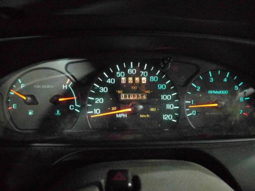

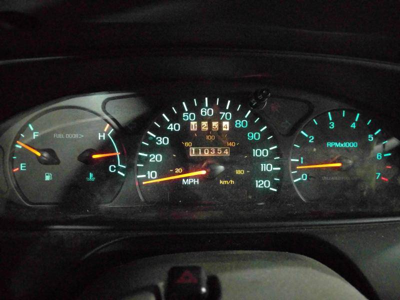

My needle sits on the mark sometimes, sometimes it sits half a needle-width below center. I'm guessing given the wide range of temperature that says "put the needle in the middle" that it's just day-to-day variances in dash temp, alternator running/not running, battery draw, friction in the motor, and position of the moon.
I'm happy to have any sort of sense behind it after driving my Taurus. The temperature range is significantly offset upwards, mirroring the gas gauge (I guess you feel better when the gas needle points upward 75% of the time). But the needle sits at neither the gauge's halfway point nor horizontal. Then, my speedometer is offset. It goes up to 120mph, but starts at 10. However, the 10 is not at the same angle as 110. This places the 60mph "mid" mark slightly before vertical. You'd think maybe it's centered on 100km/h but no, that's slightly after vertical. Now, I'm not getting bent out of shape over this, but I swear it was done on purpose to mess with anyone who pays attention

Probably. Maybe it has something to do with the resting pin, the ~115mph governor, and space needed for the gear select display with column shifters sitting in the bottom of the speedo. But yeah, Gen 3 and 4 Taurus and Sable (96-06) all have the same dash layout. And doors. They're nearly the same car at the heart of it. The two gens are almost as close to each other as the LS' "gens"
