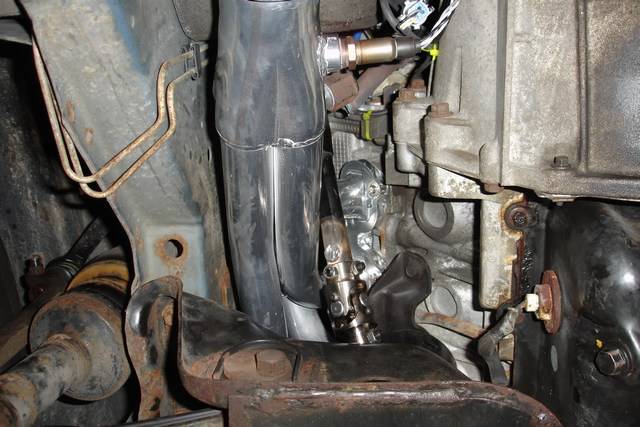

It's well known that the shaft needs to be moved....
yeah, everyone says a new rag joint and a small section of shaft is all you need. but thats not going to move the shaft enough to fit. the shaft has to move ATLEAST 2 inches over. everyone that says that hasn't done it, i have tried, a taller or shorter rag joint just isn't going to work.
Lol... you have to put a joint form a place like Flaming river in the middle of the shaft.... Just because YOU can't figure it out doesn't mean other people can't....
You can see why, here...
