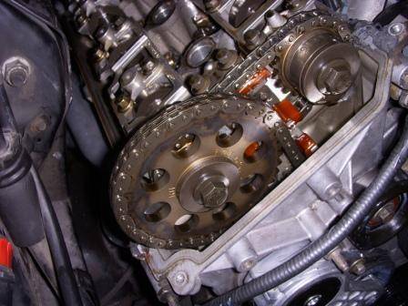

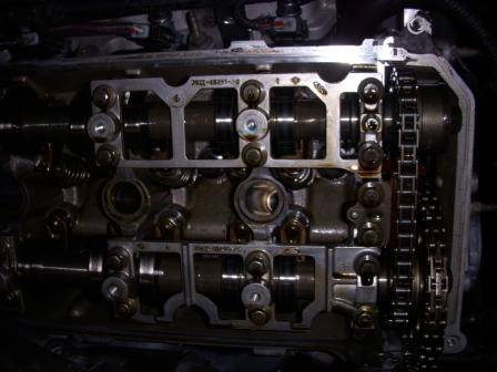

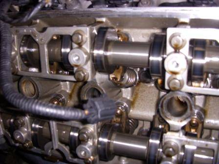

I would pull the valve cover off the side the is making all the noise.
See what I could see.
yup pull the front cover, and id replace all the guides and tensioners. should not be that much movement since the side you move in the vid is the tensioned side (i believe)
