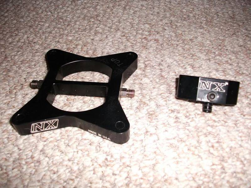

ok after thinking it over lots and lots and lots, plate is what I will be running. Plates hit a bit harder than direct inject and give up the individual cyl tuning, but will support up to 400hp easy. My single fogger nozzle wont do it, and dual means I need 4 solenoids. Direct inject is sexy as hell, but requires 8 nozzles, fuel rails, nitrous rails, distribution blocks etc. Plate it is. The down side is my set up wont be as hidden any more. So I may redo the hwole thing to display it in a sexy sort of way.
Really stupid question... where is the plate mounted? like a throttle body spacer? Nitrous newb here.
