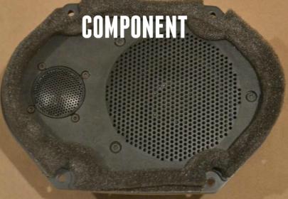

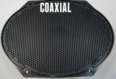

Another thing I wanted to share is that some of the LS's come with component like speakers and some with coaxial speakers.
Straight out the coaxial speaker is louder and gives more bass than the component type speakers. This is because the coaxial is an actual 5x7 size speaker and the components are a 5.25" speaker with a 1" tweeter in a 5x7 housing.
I have tried both types since I had both sets laying around and the factory coaxial's out performed the factory components.
Like I said till this day I am still using the factory coaxial's with my JL 300/4v3 amp.

actually, "coaxial" speakers would refer to two-way speakers where the tweeter is mounted dead center of the woofer. you have multiple drivers that share a common axis.
Your "coaxial speakers are just one way speakers. a lot of times the manufacture will add a second cone to the dust cap to attempt to be able to better recreate the full range of sound, commonly referred to as dual wizzer cones.
