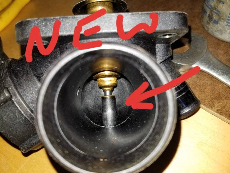

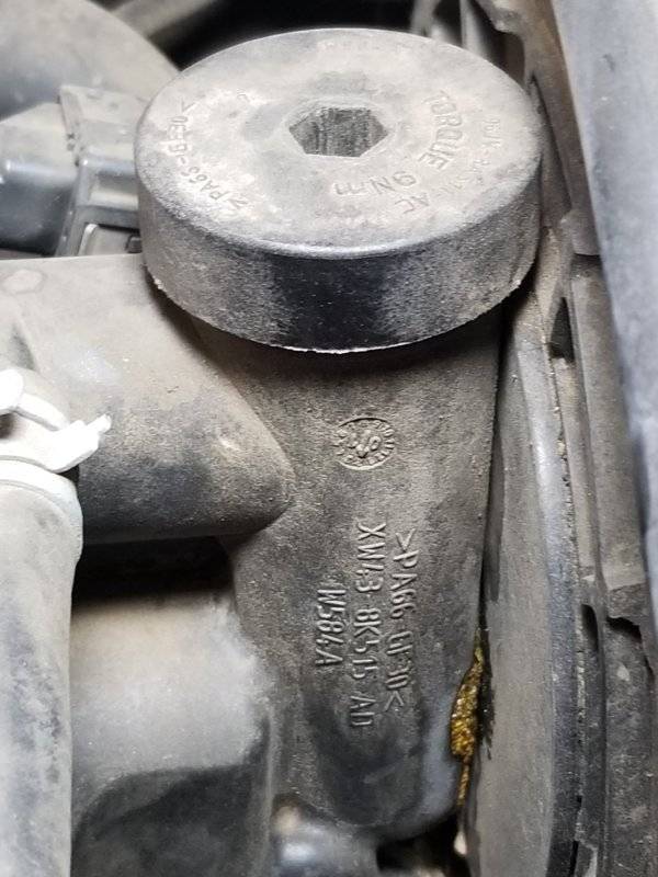

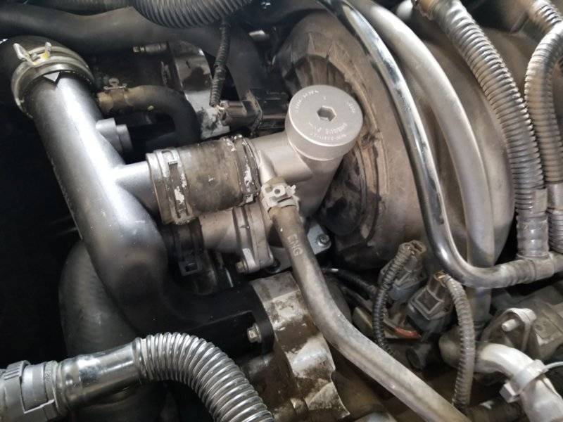

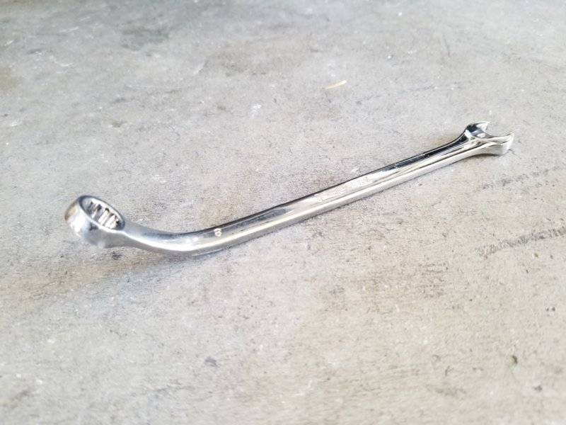

That Jaguar Thermostat Housing is a million times better than the Original and glad to see the wrench trick helped...looks good! Thanks for the updatesWell the parts arrived on Thursday and since my shop wanted $400 to do the job I decided to do it myself. The leak was in the thermostat housing and I installed the metal one from Rockauto and it is excellent. The tip on the wrench proved invaluable... attached is a photo of mine. Thanks for all the help!

got the metal thermostat housing. I believe the housing can be removed with touching the intake... with a brake bleeerb wrench and needle nose pliers for the last couple of turns.
